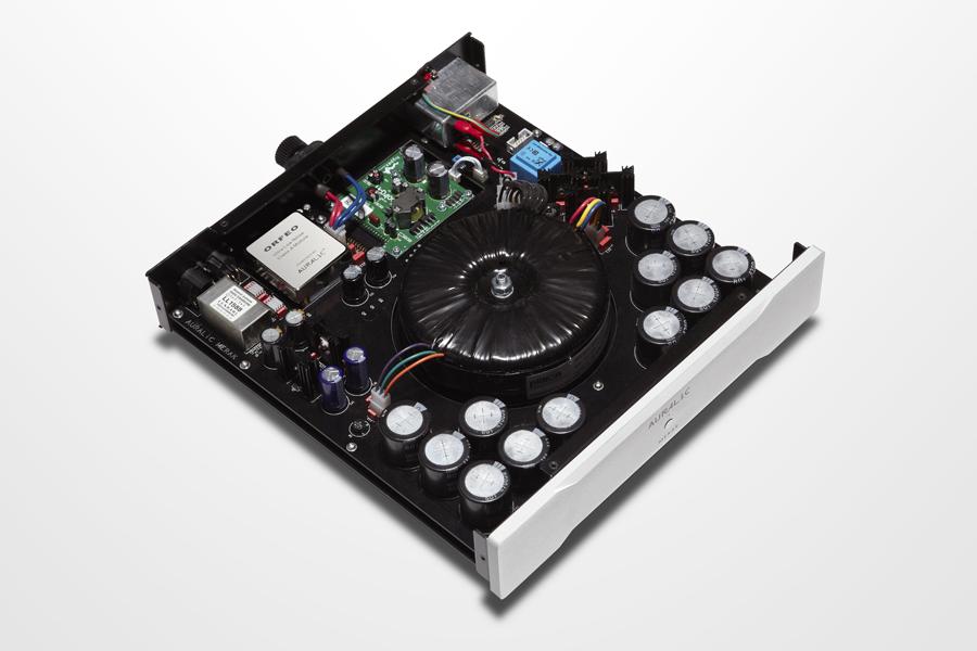

ab Posted May 29, 2019 Report Posted May 29, 2019 1 sat ranije, Majda said: Sorry na offu ali to su neka moja razmisljanja na ovu temu, a na osnovu iskustva sa Hypex Nc400 modulima. Zašto ne sa NC1200 modulima? Here's a quote from Xuanqian Wang, co-owner of Hong Kong's AURALiC whose new Merakmono amp is based on a modified UcD module with impressive before/after measurements to prove it, bypassed UcD driver in favor of their own, a Lundahl input transformer and very beefy linear power supply. Asked what he thought about Ncore, he wrote "...we have a pair of NC1200 samples which sound very natural and overtake most <$10.000 class AB amps on the market if properly used. For the next 5 years Ncore is a game changer! The only limit from a popularity perspective is price. I believe Hypex spent a lot of money developing the Ncore module. I fully appreciate their pricing structure. But so far it is veryexpensive, far beyond what we can achieve with traditional class AB technology. I think that $10,000 is just a starter price for Ncore amps Quote
Majda Posted May 29, 2019 Report Posted May 29, 2019 Pre svega sam mislo na ove 2000W module https://www.hypex.nl/product/nc2k/79 i preporucena napajanja za njih https://www.hypex.nl/product/smps3ka700/13 I na Icepower module 1200AS2 https://icepower.dk/products/amplifier-power-modules/ sa napajanjem integrisanim na osnovu pojacavaca. Znam da od originalnih postoje Icepower i Hypex kao proverene firme za ovu oblast ampova. Mozda ima i drugih proizvodjaca modula ovog tipa? Za ove snage, kopije uopste ne bih razmatrao. (Kod tih Merak ampova je suvise mali mrezni trafo koji napaja oba kanala... Ne bih to ozbiljno razmatrao... to je ipak definisano na ukupnih 800W za stereo.... Ulazni trafo da ali ipak kbalitetniji od tih koji su stavili a koji nisu losi.) Quote
ab Posted May 29, 2019 Report Posted May 29, 2019 45 minuta ranije, Majda said: (Kod tih Merak ampova je suvise mali mrezni trafo koji napaja oba kanala... Ne bih to ozbiljno razmatrao... to je ipak definisano na ukupnih 800W za stereo.... Ulazni trafo da ali ipak kbalitetniji od tih koji su stavili a koji nisu losi.) Merak mono? Quote
lalelala Posted May 29, 2019 Report Posted May 29, 2019 33 minuta ranije, ab said: Merak mono? da, Merak je mono 250W Quote
Zexx Posted May 29, 2019 Report Posted May 29, 2019 Kopije? Kakve bre kopije spominjete, pa nije to kit od 15 delova iz radio kluba da može tek tako da se kopira?! A za komentare na Auralic Merak šta reći a ne zaplakati, "onolicni" toroid na monoblok u D klasi od 200W na 8 oma, a naučismo usput i da je Lundahl đoka od trafoa... Quote
sondek Posted May 29, 2019 Report Posted May 29, 2019 Da Lundahl baš Đoka,i u Linn ampovima od 10k su... Quote
lalelala Posted May 29, 2019 Report Posted May 29, 2019 18 minuta ranije, Zexx said: Kopije? Kakve bre kopije spominjete, pa nije to kit od 15 delova iz radio kluba da može tek tako da se kopira?! A za komentare na Auralic Merak šta reći a ne zaplakati, "onolicni" toroid na monoblok u D klasi od 200W na 8 oma, a naučismo usput i da je Lundahl đoka od trafoa... Imao sam priliku da slušam Merak u jako ozbiljnom multi amp sistemu sa YG Sonja 2.2 zvučnicima ... fenomenalan zvuk. Ozbiljna je to kutijica, jako ozbiljna ... Quote
dj.nik Posted May 29, 2019 Report Posted May 29, 2019 49 minuta ranije, Zexx said: Kopije? Kakve bre kopije spominjete, pa nije to kit od 15 delova iz radio kluba da može tek tako da se kopira?! A za komentare na Auralic Merak šta reći a ne zaplakati, "onolicni" toroid na monoblok u D klasi od 200W na 8 oma, a naučismo usput i da je Lundahl đoka od trafoa... Uživanje je, kao i uvek, čitati Vaše postove. Quote
