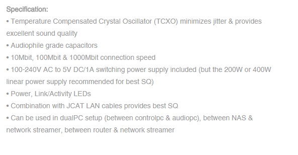

garson Posted October 26, 2017 Report Posted October 26, 2017 Ima i JPlay/JCat nesto slicno, D-Link audiofilski switch za 200e. Quote

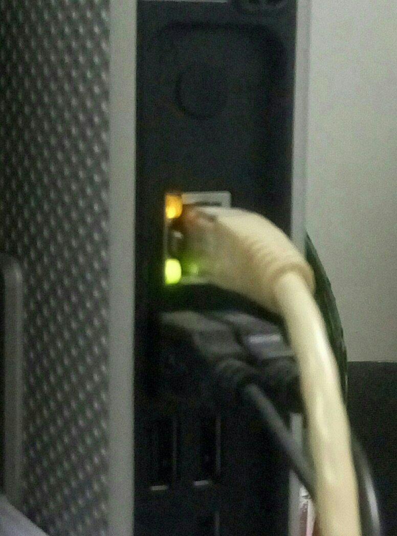

ab Posted October 26, 2017 Report Posted October 26, 2017 Dakle i ja na ovom malom HPu imam Audio Grade Ethernet konekciju Quote
