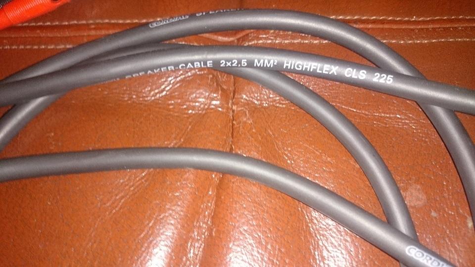

Engine Posted October 1, 2018 Author Report Posted October 1, 2018 Evo recimo ovo je razglasni kabal: https://postimg.cc/sBBN1y5Y. Cijene su pristojne, oko 3e, iako je meni prodavac rekao- kabal je vrlo skup, košta čak 3 e/m (teorija relativiteta na djelu) Šta mislite o ovim kavlovima? Quote

Engine Posted October 1, 2018 Author Report Posted October 1, 2018 Tj ovaj, cordial cls 225: https://www.thomann.de/gb/cordial_cls_225.htm Quote

vladat1 Posted October 1, 2018 Report Posted October 1, 2018 Imam ja ovaj Cordial, ali sve jedno vuče me da isprobam još neki . Quote
