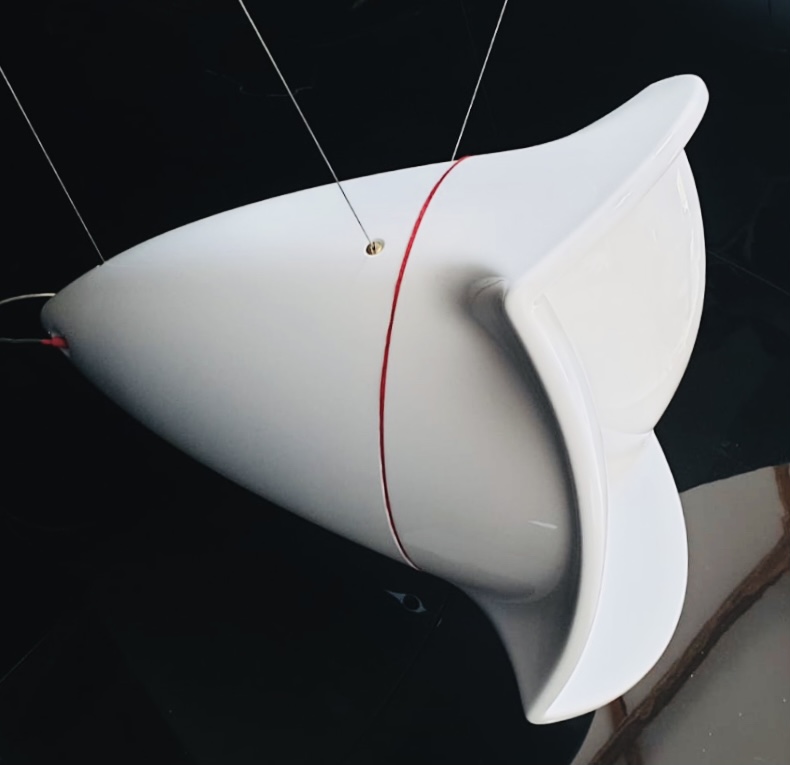

swenthehornmaker Posted January 22, 2021 Report Posted January 22, 2021 20 hours ago, džonibigud said: Ovo izgleda kao da je van ovoga sveta Hvala Vam. Željno očekujem više detalja. That's a three way full activ, exponentiall front loaded system. Also in this system we use a concentric arrangement of all three horns. The bass horns in the back (there are two of them) are called Octahorn. 480 kg each one, 4 15" and the air column is more than 300 cm long. The bass is clearer than anything I ever heard before. In use from 18,5Hz up to 80Hz. The big baby's ob the front are Replicas of the Western Electric 15A. 435 cm long. Cut-off 51Hz. We use them from 100Hz up to 1200Hz and the white one is the Elysio HT9 with Beryllium tweeter. Usable from 900Hz. We use them from 1250Hz. The whole system is driven by our dsp "The Room". All fir filters except the bass to the low end. It is 100% phase correct and time aligned. Best regards Swen Quote
