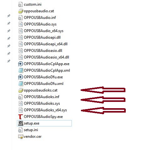

dj.nik Posted January 8, 2018 Report Posted January 8, 2018 Proverio obe verzije Oppo USB drajvera, 1.61 i najnoviji 3.26, oba nude podrsku za asinhroni USB prenos i Kernel Streaming. Quote
prophet Posted January 8, 2018 Report Posted January 8, 2018 Oppo instalira samo asio driver a ovako bez oppoovog OEM drivera, nema nijedan output sa KS: Oppo nesto... Nema veze i onako USB 2.0 radi perfektno u Win10. Hvala u svakom slucaju. Iskreno ne instalira mi se ponovo oppoov driver jer je definitivno losije radio od ovog na DSD: WASAPI Push... Da li imas instaliranu kernel komponentu na f2k? Quote
Father Posted January 8, 2018 Report Posted January 8, 2018 Imam instaliranu Kernel komponentu u foobaru, ali ne vidi oppo i ne pojavljuje se u output listi. Nisam instalirao oppo driver. Quote
Father Posted January 8, 2018 Report Posted January 8, 2018 39 minuta ranije, DJ.NIK said: Proverio obe verzije Oppo USB drajvera, 1.61 i najnoviji 3.26, oba nude podrsku za asinhroni USB prenos i Kernel Streaming. Znaci treba mi oppo driver instaliran da bi radio kroz kernel stream. Quote
dj.nik Posted January 8, 2018 Report Posted January 8, 2018 Tako je. I nista nemoj da de-instaliras (M$ Njinjdous USB drajver) pa vrati na DSD WASAPI push ako ti ne odgovara zvuk. Licno misljenje, WASAPI ti je najlosija opcija. KS pa original ASIO pa (ako se mora) WASAPI drajver. Da KS radi kako treba vidis i po tome da slajder za jacinu fuJbar ne radi, sto je znak da se zaobilaze posrednici. Kod DSD i ne postoji nacin regulacije jacine interno vec svakako mora spolja, u nekoj predpojacavackoj sekciji. Quote
Father Posted January 8, 2018 Report Posted January 8, 2018 Hvala! Probacu driver, pa cu sutra poslusati kako radi. Javljam utiske. Svima hvala. Quote
Zexx Posted January 8, 2018 Report Posted January 8, 2018 1 sat ranije, DJ.NIK said: EDIT na gornji post: Citajuci uputstvo sa Oppo sajta, ti bi Morao da imas i KS opciju za Oppo 103 & 105! Clanak ovde: http://wiki.oppodigital.com/index.php?title=BDP-105_Asynchronous_DAC_FAQ Imaće. U Windows XP... Quote
dj.nik Posted January 8, 2018 Report Posted January 8, 2018 Nemo' zbunjujes co'eka. Radice fujbar KS komponenta i na W10. Ona slicica moja jeste iz paketa drajvera 3.26 a moze da proba i kako rade stariji drajveri. A kad malo poslusa KS kroz fuJbar, ondaK cu da ga kratko uputim da instalira pravi audio softver. Ako nudi pivo, jelte Quote
Father Posted January 8, 2018 Report Posted January 8, 2018 Nudim pivo u svakom slucaju. Zexx je u pravu ne radi u win10. Intalirao sam i oppo 3.26 i pojavila su se dva KS outputa jedan cisto KS, a drugi DSD:KS: oppo.... Oba su mi davala error u reprodukciji. Ne radi. Mozda probamo kada me posetis. Neka za sada, ne mogu vise da se akam sa driverima. Ovaj windows-ov radi ekstra. Quote
dj.nik Posted January 8, 2018 Report Posted January 8, 2018 I kod mene je W10 (x64 Pro) sa sve najnovijim apdejtima na koji prikjucujem Light Harmonic GeekOut USB konverter sa istim, Ess Sabre9018 chip-om i sve radi (KS) sasvim normalno. Tu je i PCI kartica Infrasonic Quartet i ona radi normalno. DakleM, nesto si fujbar preterano setovao ili u prozoru Oppo drajvera nisu sve kockice na broju. Ako bafer recimo stoji na Minimum, podesi ga na Extra Safe ili Safe i slicno pa idi nanize. Nemam Oppo pa ne mogu da vidim prave opcije drajvera. Pozz. Quote
