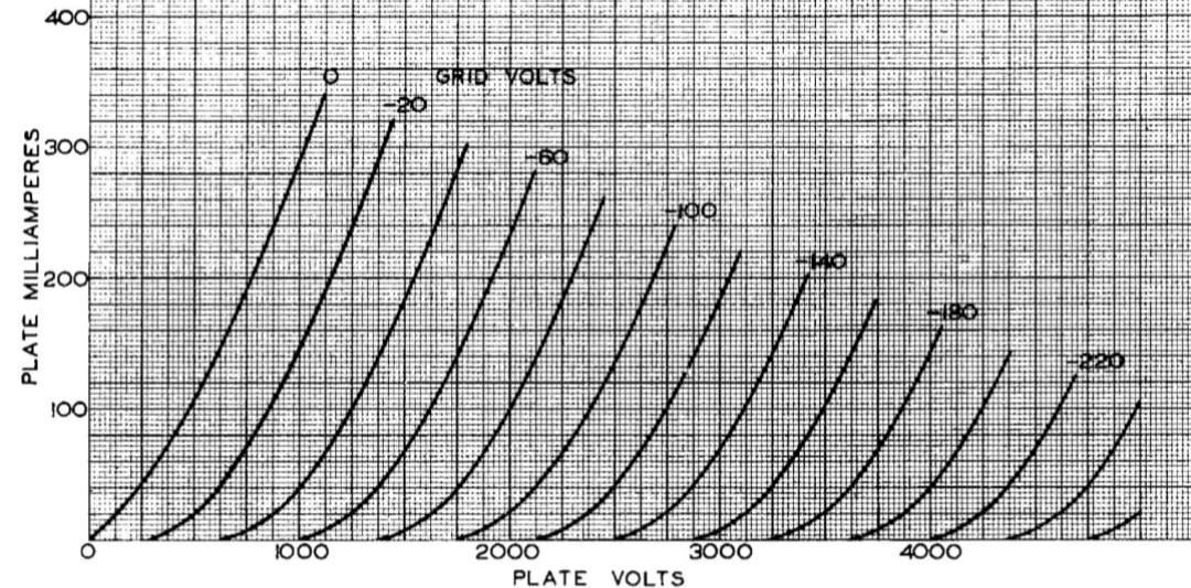

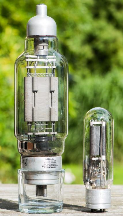

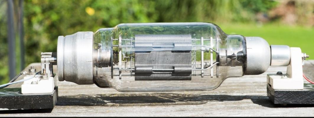

pollux Posted March 22 Author Report Posted March 22 Dugo se nisam družio sa HiFi-jem sto zbog zdravstvenih, sto zbog poslovnih problema. Nije bilo vec par godina nikakvih projekata. Sistem skoro i da nisam palio osim slušalica AKG K1000 (thanks to @Golum). Sada ponovo polako imam entuzijazma pa počinjem sa Miroslavom projekat single ended monoblokova sa 849 Amperex (zvučno najbolja lampa koju sam do sada čuo) lampama koji će biti malo ispod 90W single end. Slika lampi je sa neta samo kao poređenje u veličini sa 845 lampama koje sada koristim. The 849 has a maximum plate dissipation of 300W. This comes with a relatively high amplification factor of 19 and a plate resistance of about 3 kOhms. The Amperex data sheet lists single ended Class A operating points up to 100W out of one tube Of course such a power rating is not easily obtained. A DC supply voltage of 3kV would be needed and the filament consumes 11V @ 5A An amplifier with this tube would be a nice room heater. 300W plate dissipation plus 55W filament power equals to 355W of heat just from the tube. That's 700W for stereo. Add driver and rectifier tubes and losses in the power supply and the heat will be beyond 1kW. Maybe something for the winter time. But it wold sound simply stunning. Quote
neskor Posted March 22 Report Posted March 22 bravo, jedva cekam nastavak ? samo mala ispravka ta cev na slici nije 845, to je 211/VT4C Quote
pollux Posted March 22 Author Report Posted March 22 1 sat ranije, neskor said: bravo, jedva cekam nastavak ? samo mala ispravka ta cev na slici nije 845, to je 211/VT4C Da u pravu si, ali je ista velicina 845 I 211. Quote

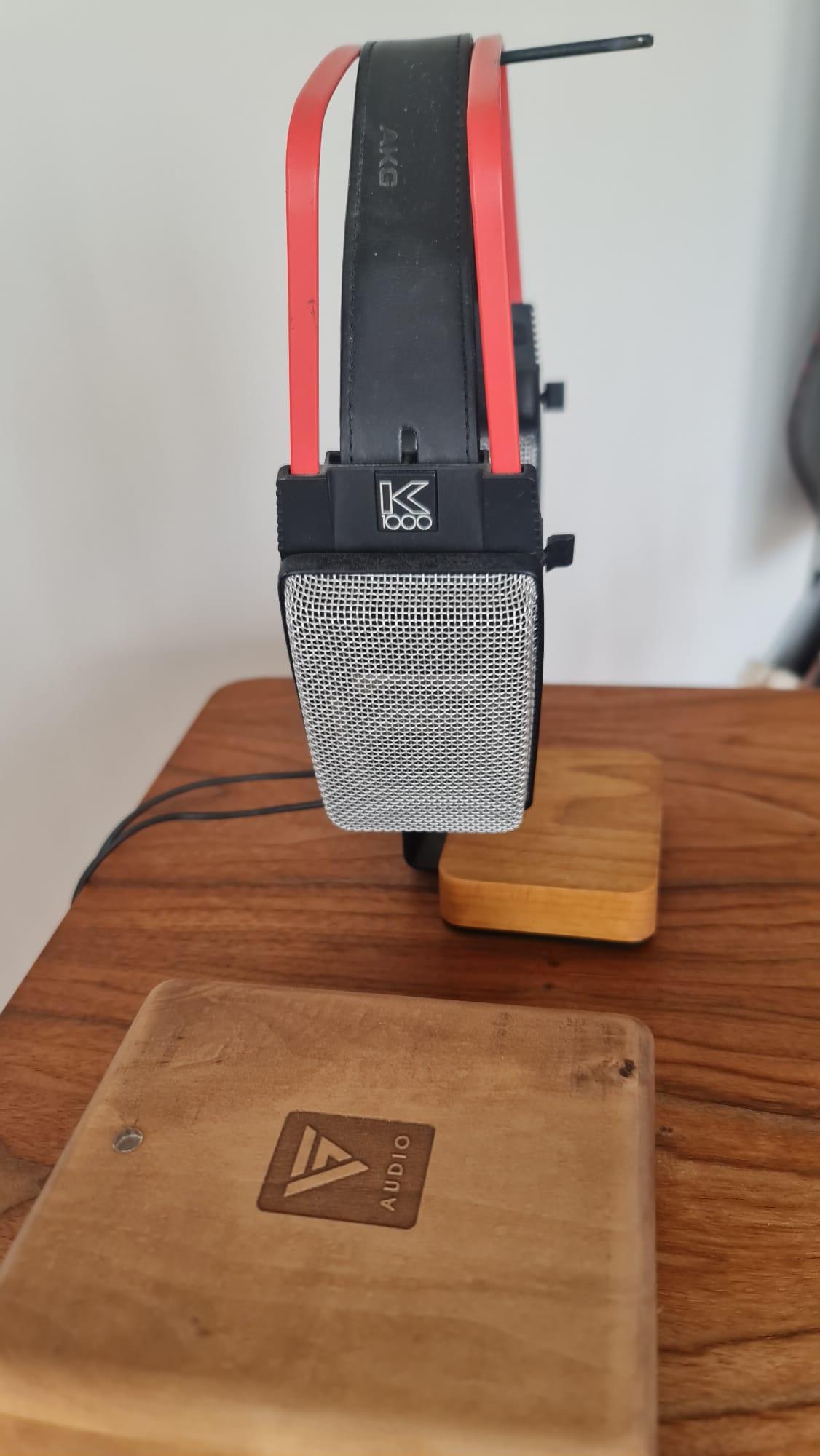

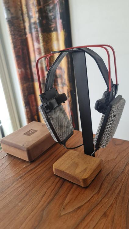

InSides Posted March 22 Report Posted March 22 9 sati ranije, pollux said: Sistem skoro i da nisam palio osim slušalica AKG K1000 Браћа Бугари кажу (парафразирам) - шта човеку треба осим неба, шољу кафе и звезде. Мислим да бих комотно могао да живим само са K-1000 када бих морао. И када сам више тамо, један предлог - када качиш те слушалице на држач за слушалица, покушавај користити црвене носаче, а не кожну траку - овако како их имаш се лако иста та трака растегне па онда проблеми са комфором. Немам баш свежу слику на шта мислим, али ево једне слике старије итерације мог система где се може видети о чему причам (горе десно): Quote
pollux Posted March 22 Author Report Posted March 22 2 sati ranije, InSides said: Браћа Бугари кажу (парафразирам) - шта човеку треба осим неба, шољу кафе и звезде. Мислим да бих комотно могао да живим само са K-1000 када бих морао. И када сам више тамо, један предлог - када качиш те слушалице на држач за слушалица, покушавај користити црвене носаче, а не кожну траку - овако како их имаш се лако иста та трака растегне па онда проблеми са комфором. Немам баш свежу слику на шта мислим, али ево једне слике старије итерације мог система где се може видети о чему причам (горе десно): Hvala na savetu. Pozdrav Quote
