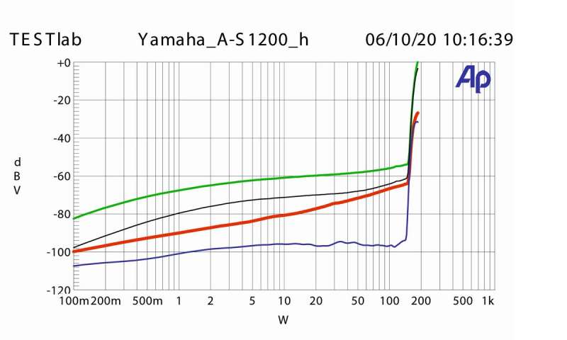

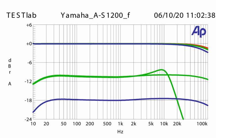

richiemsch Posted May 10, 2021 Author Report Posted May 10, 2021 Ако може појашњење ових дијаграма, био бих захвалан: Quote
zek Posted May 10, 2021 Report Posted May 10, 2021 Možda ako daš kompletan test da se vidi šta koja boja grafikona znači... Quote
richiemsch Posted May 10, 2021 Author Report Posted May 10, 2021 3 minutes ago, zek said: Možda ako daš kompletan test da se vidi šta koja boja grafikona znači... Није назначено https://www.connect.de/testbericht/yamaha-a-s1200-test-3201123.html Quote
Nixie Posted May 10, 2021 Report Posted May 10, 2021 Gore su frekventni opsezi, verovatmno za razme ulaze, dole THD gde se vidi da pojačalo ima negativnu povratnu sporegu i u skladu sa tim mala izobličenja dok se ne pretera. Vidi se daa je snaga negde između 100 i 200W kad naglo skoče izobličenja, ali je teško odrediti tačno jer je logaritamski dijagram i nije data impedansaansa na kojoj je mereno. Takođe je nejasna ona gore zelena linija koja skoči na 9k pa se sunovrati. Quote
richiemsch Posted May 27, 2021 Author Report Posted May 27, 2021 Ево нађох још један детаљан тест "Yamаha A-S1200", па нека прокоментарише свако ко разуме дијаграме и резултат тестова боље од мене... Yamаha A-S1200 Laboratory According to company information, the A-S1200 achieves 90 watts into 8 ohms and 150 watts into 4 ohms. As always, we get more: 110 W into 8 Ω and 191 W into 4 Ω with one channel driven. Driving two does not make an impression on the power supply at 8 Ω (2 x 110 W), at 4 Ω it is, but the "gain" from the lower impedance is still clear (2 x 172 W). These results are similar to those obtained by the Sphinx 3, but this time not from impulse terminals, but from classic, linear AB class circuits. Like Technics, Yamaha pedantically adheres to the 200 mV sensitivity standard - exactly this voltage applied to the amplifier's inputs will translate into the rated power. In view of such sensitivity, the noise ratio deserves recognition, S / N is 87 dB. The frequency response (Fig. 1) is excellent, with no dip at 10 Hz, just -1 dB at 100 kHz and 8 Ω, and -1.5 dB at 4 Ω. The harmonic spectrum (Fig. 2) is no longer perfect, the odd ones have the advantage, the strongest third is -70 dB, the fifth is -80 dB, and the seventh is one decibel lower; you can also see even ones - the second one at -76 dB and the fourth one at -79 dB. Therefore, THD + N (Fig. 3) is not as low as, for example, in the H95, but the characteristics are still good, below 0.1% we go down with power above 2 W for 8 Ω and 4 W for 4 Ω. The power indicators work accurately (at low power) and very accurately (at high power), when the A-S1200 indicates 1 W, we actually have 0.9 W, and when 100 W - 100 W. https://audio.com.pl/testy/stereo/wzmacniacze-stereo/3331-a-s1200 Иначе, моје кутије су на 4Ω, 150W. Quote
