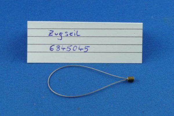

Mingus,Mingus Posted February 2, 2022 Report Posted February 2, 2022 Nasao orginal 3eura ali ne salju van Nemacke. Filzring (Gleitring) selbstklebend für Haubenscharnier TD105/110/115/126/524 Art:4312248 (bei Zugseilwechsel zwingend erforderlich) 3.- EUR https://plattenspieler-reparatur.de/thorens-gehaeuse/ Quote

Mingus,Mingus Posted February 3, 2022 Report Posted February 3, 2022 Narucio sa https://www.ebay.de Jeste skupo ali je ipak orginal resenje. Quote

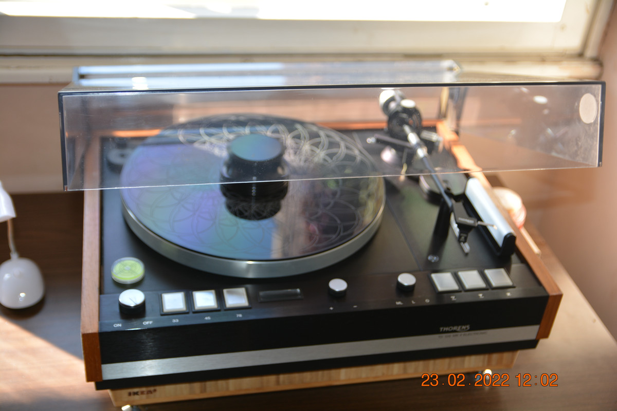

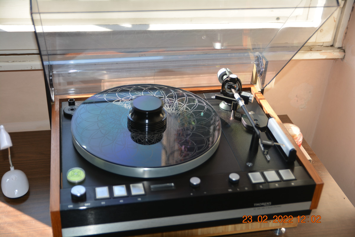

Mingus,Mingus Posted February 23, 2022 Report Posted February 23, 2022 Namestene sajle, poklopac radi odlicno. Quote
