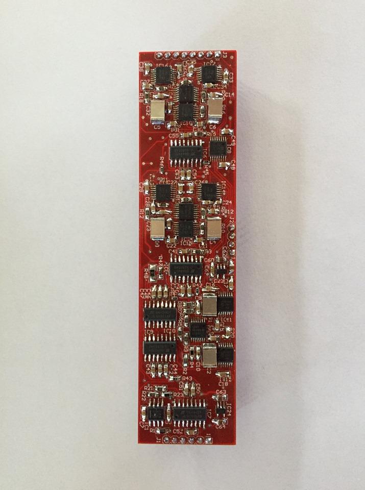

prophet Posted October 8, 2019 Report Posted October 8, 2019 M2TECH je najavio svoju verziju analogne aktivne skretnice kojom se izbegavaju A/D D/A konverzije i upotreba DSP a da su pritom programabilne. Objašnjenje: The use state variable filters in which frequency and Q are set by two variable resistors which are made with integrated ladders operated by SPI interface, operated by a controller which set via USB using a program running on a PC and stored in non-volatile memory Quote
