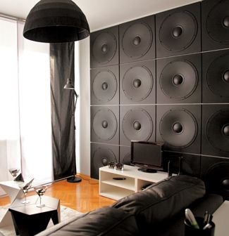

somilenko Posted April 8, 2021 Report Posted April 8, 2021 Sent from my ONEPLUS A6003 using Tapatalk Quote
hifista Posted April 8, 2021 Report Posted April 8, 2021 Zidna dekoracija, psiholoski poboljsava kvalitet basa. Quote
somilenko Posted April 8, 2021 Report Posted April 8, 2021 Koliki je drajver, vešanje mu ko hula hop.Sent from my ONEPLUS A6003 using Tapatalk Quote

srdjan_cvetkovic Posted April 17, 2021 Report Posted April 17, 2021 On 8.4.2021. at 11:06, somilenko said: Sent from my ONEPLUS A6003 using Tapatalk Ispriča čovek svašta, a muzike niđe. Quote

somilenko Posted April 17, 2021 Report Posted April 17, 2021 Ispriča čovek svašta, a muzike niđe.Pa radi se o sistemu, poprilično retkom, ne o muzici...Sent from my ONEPLUS A6003 using Tapatalk Quote
