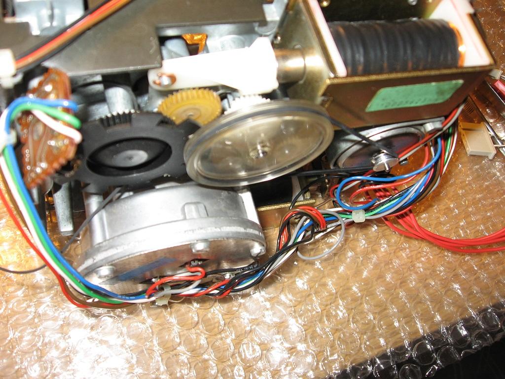

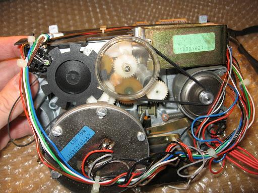

sweeT_Tooth Posted March 16, 2020 Report Posted March 16, 2020 https://ibb.co/s1TyhnL https://ibb.co/31ZhFJm Овако то изгледа, а ово треба све поскидати да би се све расклопило. Quote
