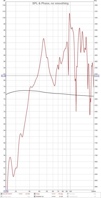

damic Posted November 24, 2020 Report Share Posted November 24, 2020 On 21.11.2020. at 20:25, Nixie said: Šta bi sa mikrofonom na kraju? .......... On 21.11.2020. at 21:46, bobangsxr said: Instalirao Sam rew program Ali nisam imao vremena da se detaljno pozabavim time, sto se tice budzeta ne bih isao preko 2500 za amplifikaciju, ako ostane rowen u sistemu onda i manje a za zvucnike ne bih preko 2000 evra polovni ali iskljucivo stereo i bez subova Pametnije ti je da se pozabavis REW-om i konacno vidis sta imas u sobi. Ovako samo gubis vreme, lutas i trosis bespotrebno novac. Kako imas mikrofon, baci na temu SPL grafik (20Hz do 200Hz) i RT60 (100Hz do 10KHz). Moze i waterfall (20Hz - 20KHz). Ovo bi bilo dosta da se nesto konkretno savetuje, ovako kao do sada, sve je mlacenje prazne slame. Link to comment Share on other sites More sharing options...
bobangsxr Posted November 24, 2020 Author Report Share Posted November 24, 2020 Evo probao nesto Link to comment Share on other sites More sharing options...
bobangsxr Posted November 24, 2020 Author Report Share Posted November 24, 2020 21 sati ranije, somilenko said: Ili kada se već priča o all in one i iznosima od 2000 e, za malo više https://elektro.bazos.sk/inzerat/117756491/predam-devialet-expert-200-stereo-zosilnovac.php I taj je dobar, mada iskreno nikad nisam devialet uzimao u razmatranje 22 sati ranije, Thecoki said: Onda kupiš H190,Moon Ace... Lepsi mi hegel, e sad koji bolje svira... Link to comment Share on other sites More sharing options...
somilenko Posted November 24, 2020 Report Share Posted November 24, 2020 Razmotri i Primare Prisma modularna integralna pojačala, i to su zanimljivi uređaji.PS: Merenje ti baš i nije nešto uspelo... Sent from my ONEPLUS A6003 using Tapatalk Link to comment Share on other sites More sharing options...
bobangsxr Posted November 24, 2020 Author Report Share Posted November 24, 2020 Imao Sam prilike skoro da cujem sonoro maestro uparen sa definitive technology bp9060, zvucnici su polu aktivni, bass je aktivan, imaju opciju I da se ne koristi njihovo ugradjeno pojacalo tako da je kompletan zvucnik isao preko sonoro. Inace sonoro maestro je pojacalo D klase. Taj Paket je bas lepo zvucao sa dosta jakim ali preciznim basom. Ne znam zasto sam sve ovo napisao 26 minuta ranije, somilenko said: PS: Merenje ti baš i nije nešto uspelo... Sent from my ONEPLUS A6003 using Tapatalk Ja se stvarno u to ne razumem, sta je potrebno da promenim da bi bilo uspesnije? Link to comment Share on other sites More sharing options...

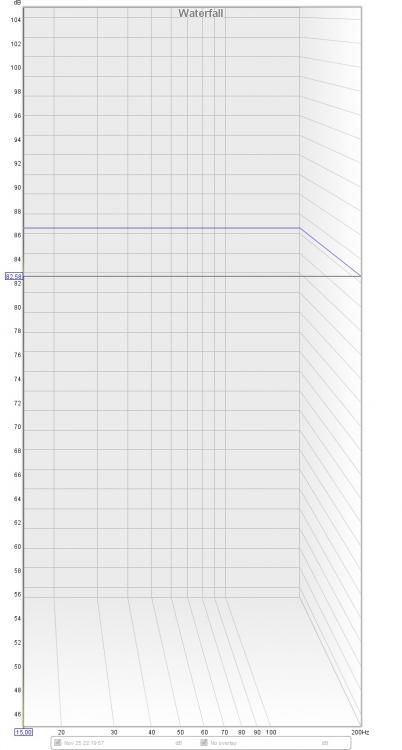

bobangsxr Posted November 25, 2020 Author Report Share Posted November 25, 2020 22 sati ranije, somilenko said: Za merenj apotraži tutorijale na YT, trebalo bi da ih ima, a napisao si onaj tekst zato što te verovatno privlači D klasa. Primare-ovi noviji integralci jesu D klasa, ali ako si zadovoljan sa tim Rawen-om, razmišljaj u pravcu DAC+preamp kombinacije... Sent from my ONEPLUS A6003 using Tapatalk Nasao sam jedan tutorijal u kome je bas lepo objasnjeno. Ja sam do sada cuo 5-6 pojacala tako da ja jos ne znam cime sam zadovoljan a cime nisam, ali polako, potrazicu jedan dobar DAC da probam sa rowenom i posle toga cu videti dali ostajem sa njim ili se trazi drugo pojacalo. PS: Zelim da se zahvalim svima koji trose svoje vreme da bi meni pomogli u resavanju hifi problema Evo i diagrama od pre 10 minuta, nadam se da je sada bolje ispalo Link to comment Share on other sites More sharing options...
Delija Posted November 25, 2020 Report Share Posted November 25, 2020 Valjda ti je jasno da ti je waterfall dijagram prazan Link to comment Share on other sites More sharing options...
bobangsxr Posted November 26, 2020 Author Report Share Posted November 26, 2020 Da primetio sam dali neko zna gde sam zakazao pa je tako ispalo? Link to comment Share on other sites More sharing options...
bobangsxr Posted November 26, 2020 Author Report Share Posted November 26, 2020 Ovaj sam odgledao i uradio sve kako je on uradio, e sad vise nisam pametan Link to comment Share on other sites More sharing options...
bobangsxr Posted November 26, 2020 Author Report Share Posted November 26, 2020 Valjda je sada sve u redu Link to comment Share on other sites More sharing options...
Delija Posted November 26, 2020 Report Share Posted November 26, 2020 I dalje nije najsrecnije - razvuci malo po horizontali taj FR (daj i jedan dijagram sa 1/6 Octave Smoothing), waterfall ti je 15 dB ispao iz "kadra"... Ali, i ovako (ako je merenje tacno) se vidi da ti je odziv ispod 200 Hz u skoro totalnoj "banani". Moras ozbiljno da se poigras pozicioniranjem zvucnika, a moguce i mesta sa kog slusas muziku. Link to comment Share on other sites More sharing options...

Delija Posted November 28, 2020 Report Share Posted November 28, 2020 Nece ti sub-ovi resiti ovo izmedju 100 i 200 Hz ni pod razno, a tesko ce i ovo od 80-100 Hz bez high-pass filtera. Link to comment Share on other sites More sharing options...
bobangsxr Posted November 28, 2020 Author Report Share Posted November 28, 2020 Sta bi mi predlozio kao resenje za ovaj moj problem Link to comment Share on other sites More sharing options...
Delija Posted November 28, 2020 Report Share Posted November 28, 2020 Predlazem ono sto sam vec napisao - da se poigras pozicioniranjem, jer je dosta jednostavnije i jeftinije od akustickog tretmana sobe. Mozda ne resis problem u potpunosti - verovatno i neces - ali mozda dodjes do koliko-toliko zdrave osnove za integraciju sub-ova. Link to comment Share on other sites More sharing options...
