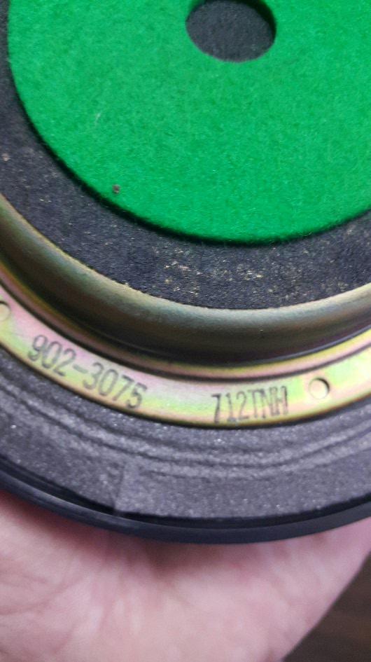

Ružić Slavoljub Posted December 30, 2018 Report Posted December 30, 2018 Dok sam se bavio kompletiranjem sistema,desio mi se defekt.Taman kad sam pronasao CD player i cass deck koji mi odgovaraju,"crkle" mi kutije.Raspali su mi se srednjetonci.Sad slusam muziku na verovatno najvecim dvosistemskim kutijama.Uzas od zvuka. Treba mi savet koje zamenske srednjotonce da ubacim.Znam da je u pitanju neki Dynaudio ali se ne secam oznake.Moze i nesto drugo,nemora Dynaudio ali da je kvalitetno. Quote

Ružić Slavoljub Posted January 3, 2019 Author Report Posted January 3, 2019 Meni - super. Nekako je cela kutija "kompletna".Sve je na svom mestu. Vrlo izbalansiran zvuk. Ničeg ni malo ni mnogo. Tako i ribonac. Čini mi se da svira baš kako treba. Ništa ne zamara. Možeš je slušati stalno i uvek. Večeras sam skinuo jedan srednjotonac da vidim oznaku . Nigde ne piše koliki je otpor. Kako to da saznam ? Quote

Nixie Posted January 3, 2019 Report Posted January 3, 2019 2 sati ranije, Peter said: Nigde ne piše koliki je otpor. Kako to da saznam ? Zar ne može da se izmeri? Quote
JTGTS Posted January 3, 2019 Report Posted January 3, 2019 hi, i have just replaced the polydomes with the scanspeak replacement. It is rated at 8ohm. It sounds bright and lively, but, as neither original polydome worked i have no way of comparing the results. for your information, the scanspeak comes in two formats, one which is in your attached picture, which has a plastic surround, and another which does not have the plastic surround.Scanspeak D7608/920010 Mid-range with surroundScanspeak D7608/920000 Mid-range without surroundBoth are available from Audio Components (uk) You will notice that you can disassemble the original polydome, being left with the original plastic surround, and the broken magnet/dome element. It is possible to glue the new scanspeak into place, and retain the original infinity polydome surrounds.To do this, either purchase the scanspeak without the plastic surround, in which case it just glues into place, or, as I did, carefully prise the plastic facia away from the drive unit of the scanspeak speaker (requires care,and a flat head screwdriver, applying pressure to the seam where the speaker driver and the surround are glued together, then cutting the glue as it stretches with a scalpel or thin knife.)When the new scanspeak drive unit is glued in place on the original infinity plastic surround, the four inner screws no longer fit, as there is no holes for them in the scanspeak speaker, so i just filed the screws down and glued them into place to retain the original appearance. Ovo sam nasao na audiokarmi Quote
Nixie Posted January 3, 2019 Report Posted January 3, 2019 15 minuta ranije, JTGTS said: Ovo sam nasao na audiokarmi Pogledaj frekventni dijagram tih D7608, to je jedno brdašce, čemu to uopšte služi? Zamena drivera ide ili originalnim jedinicama (ili originalnim recone setom), ili nekim drugim ako nema izbora ali to podrazumeva onda izmenu skretnice i puno merenja. Quote
Ružić Slavoljub Posted January 3, 2019 Author Report Posted January 3, 2019 Najviše bih voleo da repariram originalne. Sutra ću da zovem majstor Sinišu. Ako on ne može da pomogne,onda ćemo da tražimo zamenske drajvere. Meni je isto to sa skretnicom palo na pamet. Možda bi i nju trebalo doraditi ili osvežiti. Quote
Nixie Posted January 3, 2019 Report Posted January 3, 2019 36 minuta ranije, Peter said: Najviše bih voleo da repariram originalne. Sutra ću da zovem majstor Sinišu. Ako on ne može da pomogne,onda ćemo da tražimo zamenske drajvere. Meni je isto to sa skretnicom palo na pamet. Možda bi i nju trebalo doraditi ili osvežiti. Ima tih što liče po ebaju, ima i jedan američki model, ali to sve može biti mačka u džaku. Onaj beli zamenski što je bio na show je zvučao glasnije od ostalih drivera. Nije zvučalo linearno nego je bilo viška srednjih. Skretnica se može doraditi, pitanje je koliko se to isplati. Pitaj prvo Sinišu za mišljenje. Po meni za te kutije zbog veličine bas drivera pre odgovara neki konusni midrange nego taj dome, ako se već ide na prepravku. Quote
