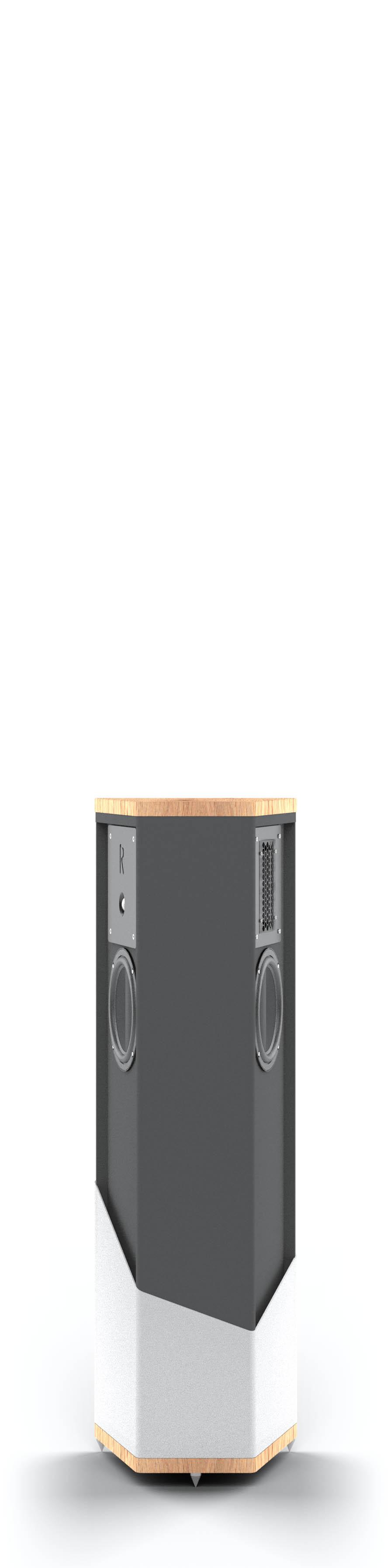

peravsp Posted July 8, 2019 Author Report Posted July 8, 2019 Evo slike. Rekoh da posaljem kad sam vec otvorio temu. Visoki sa strane je isti kao i ovaj sa slike. Postavicu i sliku skretnice pa cu otom potom, uz Vasu pomoc, da odradim i neki refresh (cisto zanimacije radi ) Quote
Zexx Posted July 8, 2019 Report Posted July 8, 2019 Visokotonac gotovo sigurno Philips, a vrlo verovatno i bas. Quote
giZ_Mo Posted July 8, 2019 Report Posted July 8, 2019 2 sati ranije, Zexx said: Visokotonac gotovo sigurno Philips, a vrlo verovatno i bas. Бас можда а високотонац вероватно SAL DT21. Quote
Zexx Posted July 8, 2019 Report Posted July 8, 2019 2 sati ranije, giZ_Mo said: Бас можда а високотонац вероватно SAL DT21. Ma nema šanse, guglaj Philips Tweeter Speaker AD 0140 T8, pa uporedi... Quote
zflazar Posted July 9, 2019 Report Posted July 9, 2019 Ma ovo je Avantgarde duo. Ili Martin Logan. Garant. Quote
giZ_Mo Posted July 9, 2019 Report Posted July 9, 2019 7 sati ranije, Zexx said: Ma nema šanse, guglaj Philips Tweeter Speaker AD 0140 T8, pa uporedi... Ма џабе упоређивање. 1 sat ranije, zflazar said: Ma ovo je Avantgarde duo. Ili Martin Logan. Garant. Ма јок, Буба Корели лимитид едишн. Quote
peravsp Posted July 9, 2019 Author Report Posted July 9, 2019 Bas AD 8061/W8 Tviter AD 0162 T8 Skretnica nije komplikovana, barem tako mislim. S obzirom da je stara kao biblija sta preporucujete da se menja. Quote
