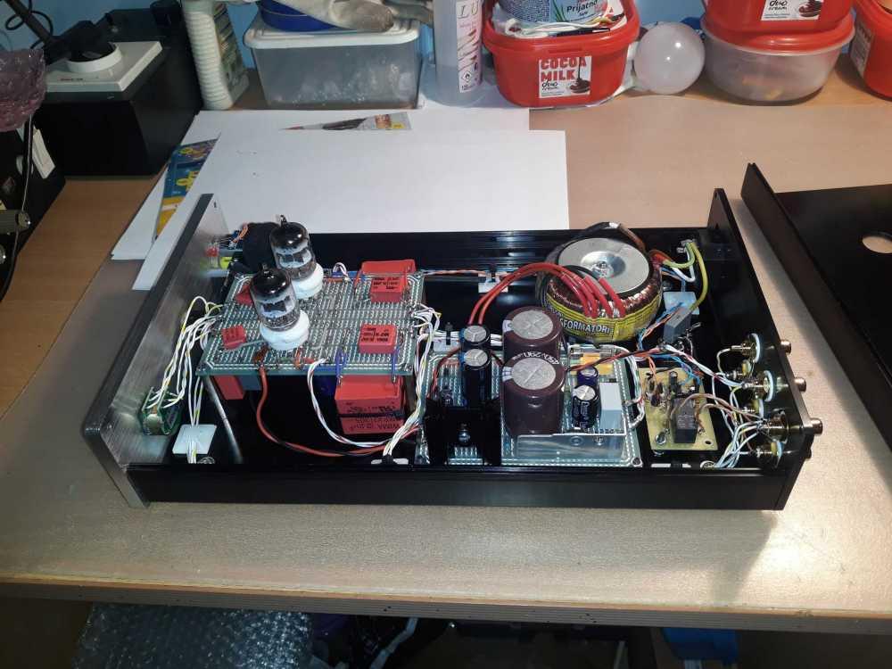

Nixie Posted January 20 Author Report Share Posted January 20 Izmereno je sledeće sa 5670 lampama: Pojačanje: 0,92 Frekventni opseg (-3dB) mereno na opterećenju 20koma+360pF: 2Hz-950kHz Izlazna impedansa 1KHz: 580oma Čiste pravilne četvrtke na 20kHz. Sad već nije više sirotinjski ni malo. Quote Link to comment Share on other sites More sharing options...
DejanM Posted February 1 Report Share Posted February 1 Vrlo lepo uradjeno. Cestitke. Quote Link to comment Share on other sites More sharing options...
Nixie Posted February 1 Author Report Share Posted February 1 Hvala. Otišlo sestri da ulepša sistem. I zvuk naravno. Quote Link to comment Share on other sites More sharing options...
