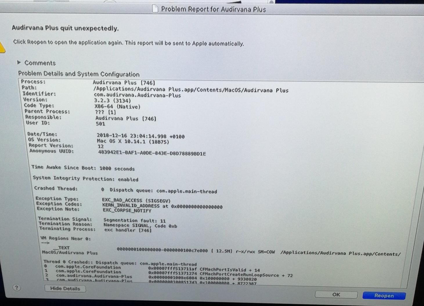

vladastevic Posted December 16, 2018 Author Report Posted December 16, 2018 Mislim da je ovo problem kod mene Quote
vladastevic Posted December 16, 2018 Author Report Posted December 16, 2018 39 minuta ranije, Gile said: Jel ti aktivan Accessibility red kad hoćeš sa dodaš app? To je takođe bitno. Nikako ne mogu da ubacim u listu Quote
Gile Posted December 16, 2018 Report Posted December 16, 2018 Vlado, a koja opcija ti je izabrana na General tabu, u Allow apps downloaded from? Treba da bude srednja. Quote
vladastevic Posted December 16, 2018 Author Report Posted December 16, 2018 2 minuta ranije, Gile said: Vlado, a koja opcija ti je izabrana na General tabu, u Allow apps downloaded from? Treba da bude srednja. Sad mi je treca opcija 'Anywhere' Quote
vladastevic Posted December 16, 2018 Author Report Posted December 16, 2018 I kad je srednja isto se ponasa. Quote
Gile Posted December 16, 2018 Report Posted December 16, 2018 Mnogo mi je to čudno. Jel se Audirvana plaća? Jel može screenshot detalja greške (ako postoji)? Quote
vladastevic Posted December 16, 2018 Author Report Posted December 16, 2018 12 minuta ranije, Gile said: Mnogo mi je to čudno. Jel se Audirvana plaća? Jel može screenshot detalja greške (ako postoji)? Izbaci neku ogromnu listu kao problem. Placa ako kupis legalno, imam 3 instalacije razlicite i isto se desava,. Na OS Yosemite sve radile normalno Quote

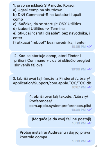

Gile Posted December 17, 2018 Report Posted December 17, 2018 Ajd rešićemo sutra. Pišem ti na PP, a ovde ćemo da objavimo rešenje. Quote

Gile Posted December 17, 2018 Report Posted December 17, 2018 Rešili smo problem, rešenje je ovo ovde: Ima i dopuna. Na kraju treba ponovo uključiti SIP mode. To se rešava ponovljenim korakom 1, s tim što tačka e) treba da bude "csrutil enable". Vlado, uradi i ovo kad stigneš. Quote

vladastevic Posted December 17, 2018 Author Report Posted December 17, 2018 21 minuta ranije, Gile said: Rešili smo problem, rešenje je ovo ovde: Ima i dopuna. Na kraju treba ponovo uključiti SIP mode. To se rešava ponovljenim korakom 1, s tim što tačka e) treba da bude "csrutil enable". Vlado, uradi i ovo kad stigneš. Nisam ali uradicu, audirvana radi sad. Jos jednom hvala na strpljenju i odvojenom vremenu. Quote
Gile Posted December 17, 2018 Report Posted December 17, 2018 Willi Studer said: Otkad su uveli SIP u OS, moraš da hakuješ rođeni kompjuter da bi instalirao nešto kao da nije tvoj. To je sporadična pojava, nisam uspeo da uhvatim pravilo zašto se dešava. Moj kum je recimo imao stravičnih problema sa SIP modom na MBP15 2015 late, dok se meni ništa problematično nije dešavalo ni na jednom od tri Mac računara (2012-2018). Quote
