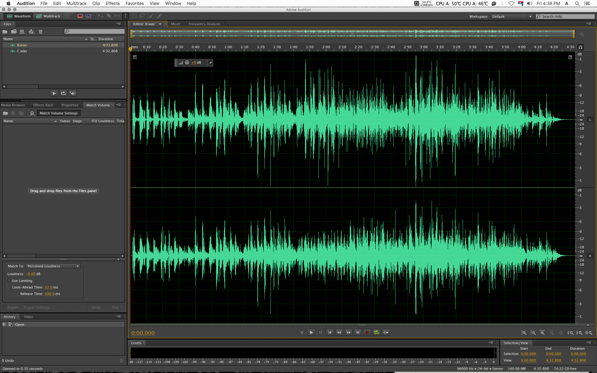

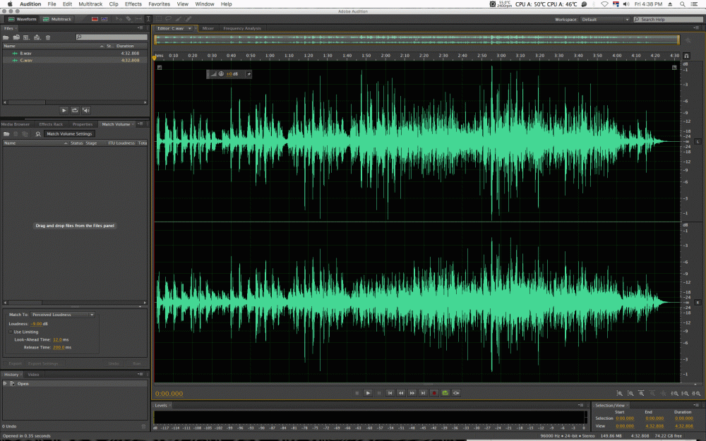

空也 Posted October 5, 2018 Author Report Posted October 5, 2018 Za početak, upoznavanje sa načinom testiranja... Null test je tehnika koja se među audio profesionalcima često koristi. https://recording.org/threads/null-testing.51987/ Regarding "Null testing"- Basically; null tests are useful to determine if two files are identical. If they are different; you hear only the difference. For those unfamiliar with the term; this test is to determine whether or not two digital recordings (files) are identical. In order to make a meaningful comparison, any potential difference must be addressed so that when the two files are added (mixed) "out-of-phase" they cancel each other, and the difference is silence. This requires the files to contain exactly the same audio content, for the files to be sample-accurate with each other, and for the level to match very exactly. Typically, the files are placed on two separate tracks and one of the two tracks is moved in the timeline to align the waveforms to a sample-accurate position. The polarity of one track is inverted so the audio content of the two tracks are "out-of-phase" with each other. If there is any difference in the level, the digital level control can be used to minimize this; but unless the difference is zero or exactly equal to the step-size of the digital level control; there will be a small level difference. This would cause two files that are identical in every other way to not cancel out completely. The usefulness of a null test is extremely limited in determining the difference from the "ideal" as, for example; if either file is "brighter" than the other (has more treble), the difference will be very bright. It is not possible to determine which of the two is brighter by simply listening to the difference; or whether one has more low treble and the other has more high treble and the audible effect is a combination of the two. This applies to ALL differences, including distortion. If one file had only even-order harmonic distortion and the other contained only odd-order harmonic distortion, the null test result would contain both even and odd order harmonic distortion and there would be no way to determine which file contained what distortion simply by listening to the null test result. So, like many tests; the null test tells you exactly one thing and the results need to be interpreted accordingly. The main reason I used a null test in the past was to determine whether the CD plant had done processing to the Mastered file I sent before manufacturing the CD. In this case; the only important thing was whether or not there was ANY difference. If there was; I knew that something had changed and would contact the plant to arrange to have it re-done. In this case; it did not matter what the difference was (or how it sounded). The only other application was to determine if the files remained in time with each other. This can be useful if there is a chance that either an edit or a digital "glitch" caused some of the original file to be missing from the copy. In this case; even if there was an audible difference caused by something like AD and DA conversion, it would remain constant unless there was an edit or missing samples. At the point where the change occurred; the "difference" output would suddenly increase in volume because the two waveforms were no longer close enough in content for phase cancellation to "null" most of the signal. Brad Johnson Lavry Engineering, Inc. https://science-of-sound.net/2016/06/null-test-business/ How to do a Null Test Anyway, there are some cases where this test comes in handy. And luckily it’s quick and easy to do. All you have to do to test if two signals are identical is to mix them together while flipping the polarity of one of them. If the result is pure silence, the two signals are equal. Well, silence is relative. If you don’t hear anything, that doesn’t mean that there really is nothing left at all. Maybe you just need to turn up the volume. There is only one case where the test is really meaningful, and that’s when – in a digital system – you get complete digital silence. In other words, an audio file full of zeros. That means that the two audio streams were really identical bit by bit. As a funny side note, I was actually once confronted with claims that two bit-by-bit identical audio files can still sound different because quantum mechanics or something. But I digress. Quote

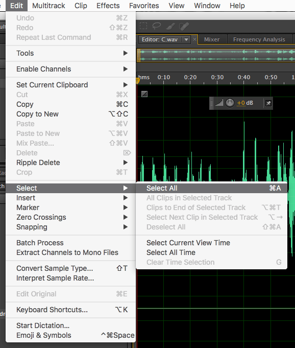

空也 Posted October 5, 2018 Author Report Posted October 5, 2018 Prevedeno na srpski… Kako bi smo utvrdili da li su dva audio fajla potpuno identična, potrebno je da ih otvorimo u programu za audio editing (u ovom slučaju Adobe Audition), te da jednom od ta dva fajla invertujemo fazu, pa da ga miksujemo sa drugim fajlom čija je faza ostala nepromenjena. U slučaju da je audio zapis u oba fajla identičan, zbog različitih faza će doći do potpunog potiranja signala i rezultat će biti potpuna tišina. Veoma bitna napomena! Kako bi test bio uspešan, fajlovi moraju biti poravnati po vremenskoj osi u sempl, što u slučaju falja semplovanog na 96kHz znači da prezicnost poravnjavanja mora biti devedeset šest hiljaditi deo sekunde. Kako je to izgledalo u praksi, tokom ovog testa: Otvaramo dva fajla koje poredimo, u ovom slučaju B i C. Zatim zaberemo jedan od ta dva fajla, recimo C, i uradimo “select all”, …pa uradimo “copy”. Quote

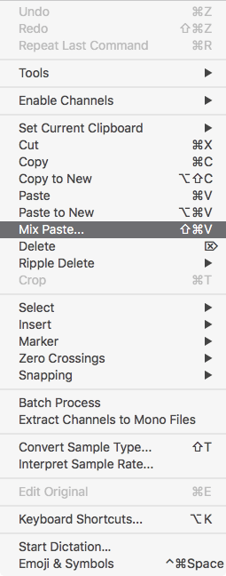

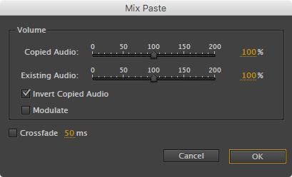

空也 Posted October 5, 2018 Author Report Posted October 5, 2018 Posle kopiranja pređemo na drugi fajl, u ovom slučaju B, i njega celog selektujemo sa “select all”, a zatim idemo na “mix paste” komandu, gde moramo čekirati opciju “Invert Copied Aidio”. Oba slajdera moraju biti postavljena na 100%. Quote

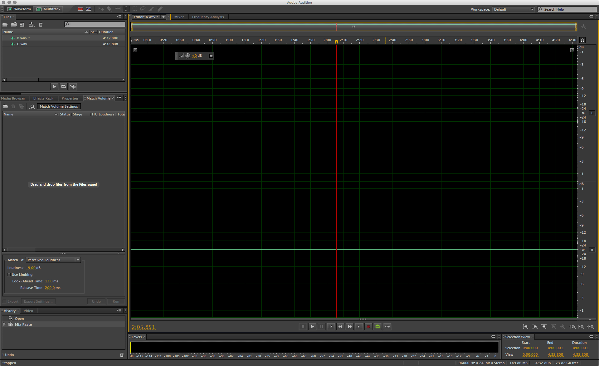

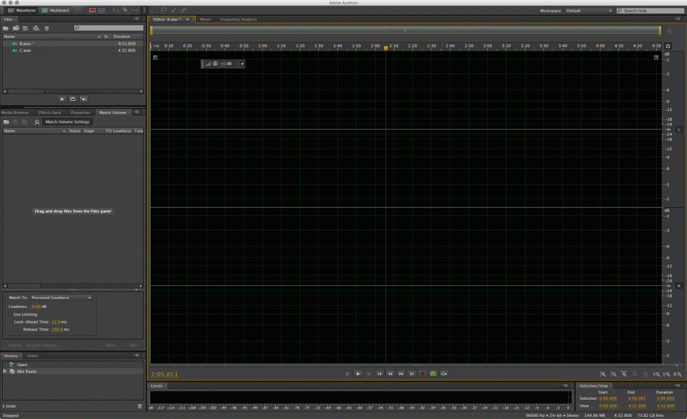

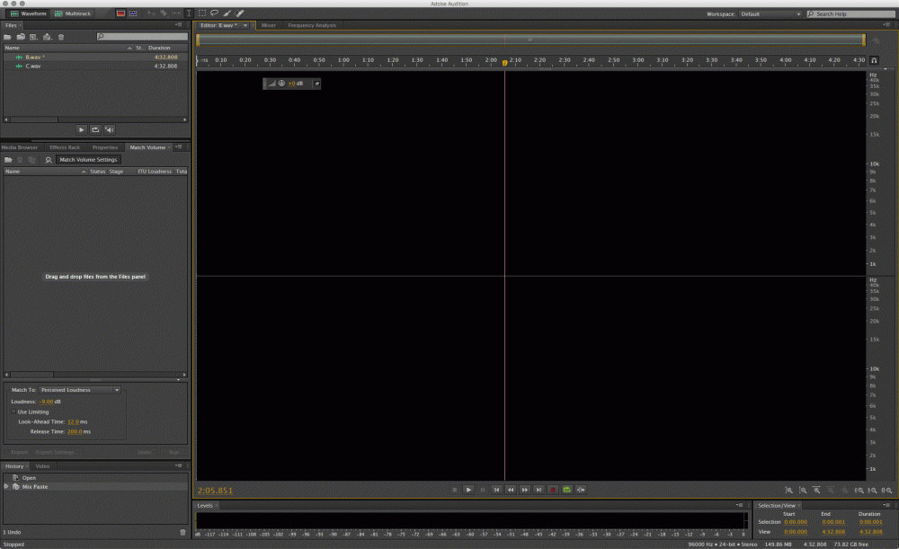

空也 Posted October 5, 2018 Author Report Posted October 5, 2018 I gle čuda, posle ovog niza operacija, ako su dva fajla bila identičnog sadržaja, rezultat je prazan fajl! Quote

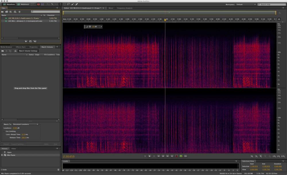

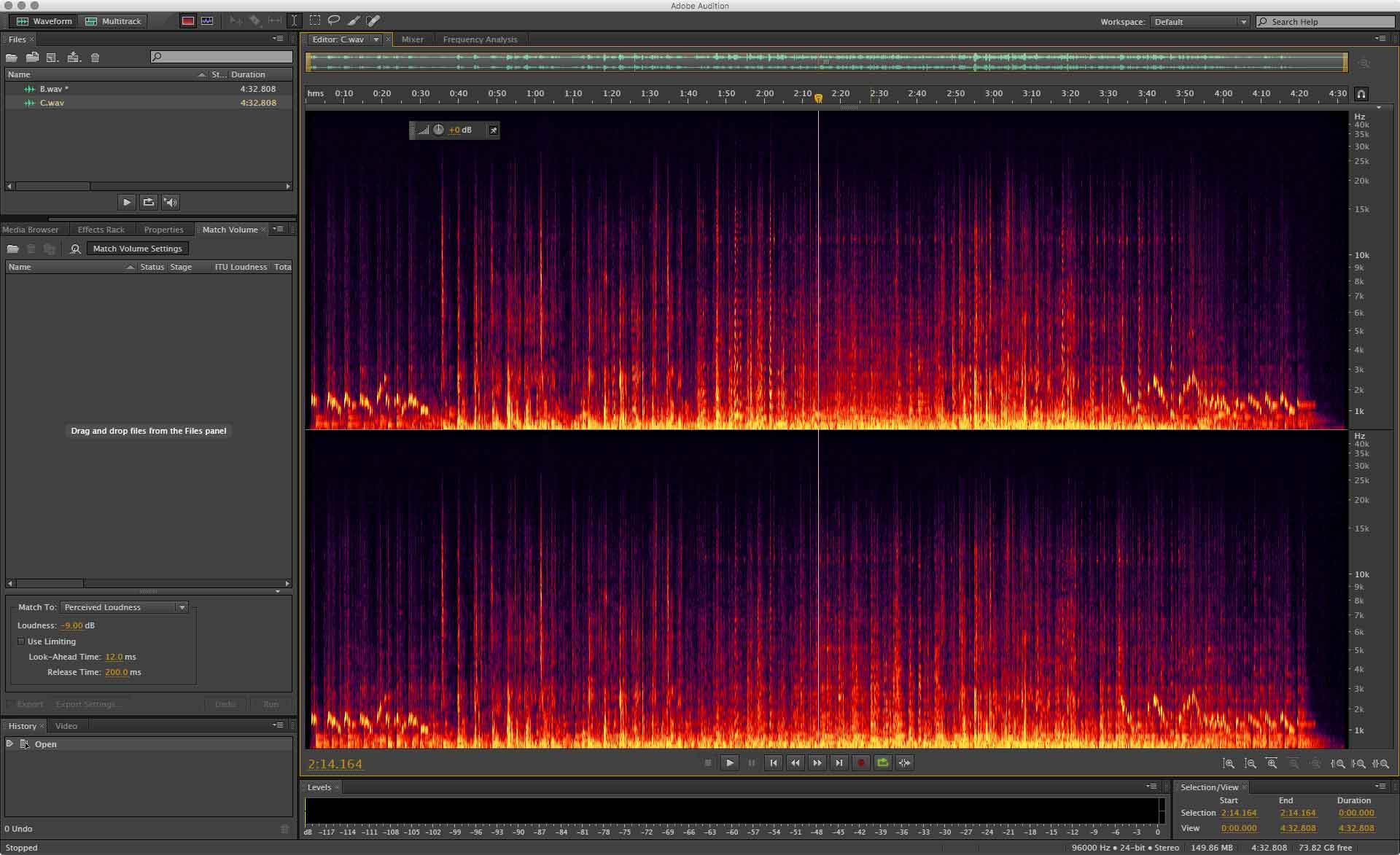

空也 Posted October 5, 2018 Author Report Posted October 5, 2018 Spektralni sadržaj fajla B pre i posle miksovanja sa invertovanim sadržajem fajla C sa kojim smo ga poredili… Pre: Posle: Quote
空也 Posted October 5, 2018 Author Report Posted October 5, 2018 Frekvencijska analiza fajla B pre i posle miksovanja sa invertovanim sadržajem fajla C… Pre: Posle: Quote
空也 Posted October 5, 2018 Author Report Posted October 5, 2018 Na osnovu gornjih slika vidimo da je između dva fajla, obrtanjem faze jednog, posle miksovanja došlo do potpunog međusobnog poništavanja tj. nulovanja. Toliko za sada, moram da izađem iz kuće da nešto završim, vi u međuvremenu možete da postavljate pitanja ako vam nešto nije jasno u vezi testa. ...A tu je i Google, pretraga "audio null test" će dati mnogo rezultata. Quote
Father Posted October 5, 2018 Report Posted October 5, 2018 2 minuta ranije, 空也 said: Pre: Ovde ti se vide neka dva različita odziva preklopljena? Quote
空也 Posted October 5, 2018 Author Report Posted October 5, 2018 Jok, u pitanju su frekvencijski odzivi levog i desnog kanala istog fajla. Quote

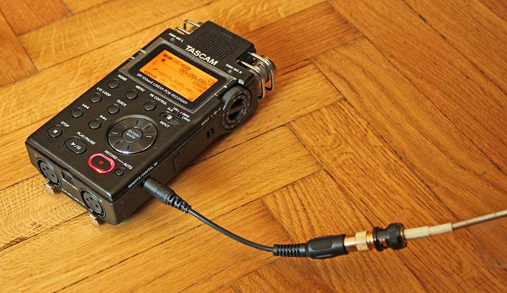

空也 Posted October 8, 2018 Author Report Posted October 8, 2018 Krenuo sam u poređenje. Na moje sada ne tako veliko iznenađenje, pošto me je prethodni slušni test na to već delimično pripremio, utvrdio sam da između test fajlova nema NIKAKVE razlike. Svi fajlovi sa oba operativna sistema i sa svih plejera su bili, u svim mogućim međusobnim kombinacijama, 100% “nulovani”. Dobijena je apsolutna tišina pošto su se fajlovi međusobno potpuno poništavali. Rezultati su govorili da nikakvih razlika između različitih plejera i operativnih sistema NEMA. ———— Naravno, audiofilski crv sumnje je radio, jer zaboga, ja sam te razlike ranije jasno i glasno ČUO, pa sam posumnjao da možda TASCAM u stvari nije dovoljno audiofilski sofisticirana sprava, te da ne uspeva da uhvati sve nijanse SPDIF signala, što je potpuno nelogično, ...ali šta je u audiofiliji logično?! Zato sam za probu u Audirvani i HQ player-u uključio SRC filtere i prebacio ih sa linear phase na minimum phase, …i BAM, odmah su se na null testu pojavile primetne razlike u odnosu na neprocesirani izlaz tih istih plejera. Znači sve radi kako treba, razlike (gde ih ima) se mogu jasno videti: Poređenje između dva različita plejera, oba sa isključenim procesiranjem, razlike nema, fajl se sastoji od tišine: Razlika koja se javlja pri poređenju istog plejera sa isključenim/uključenim procesiranjem, vidljiv je rezultat nepotpunog nulovanja dva fajla: Quote

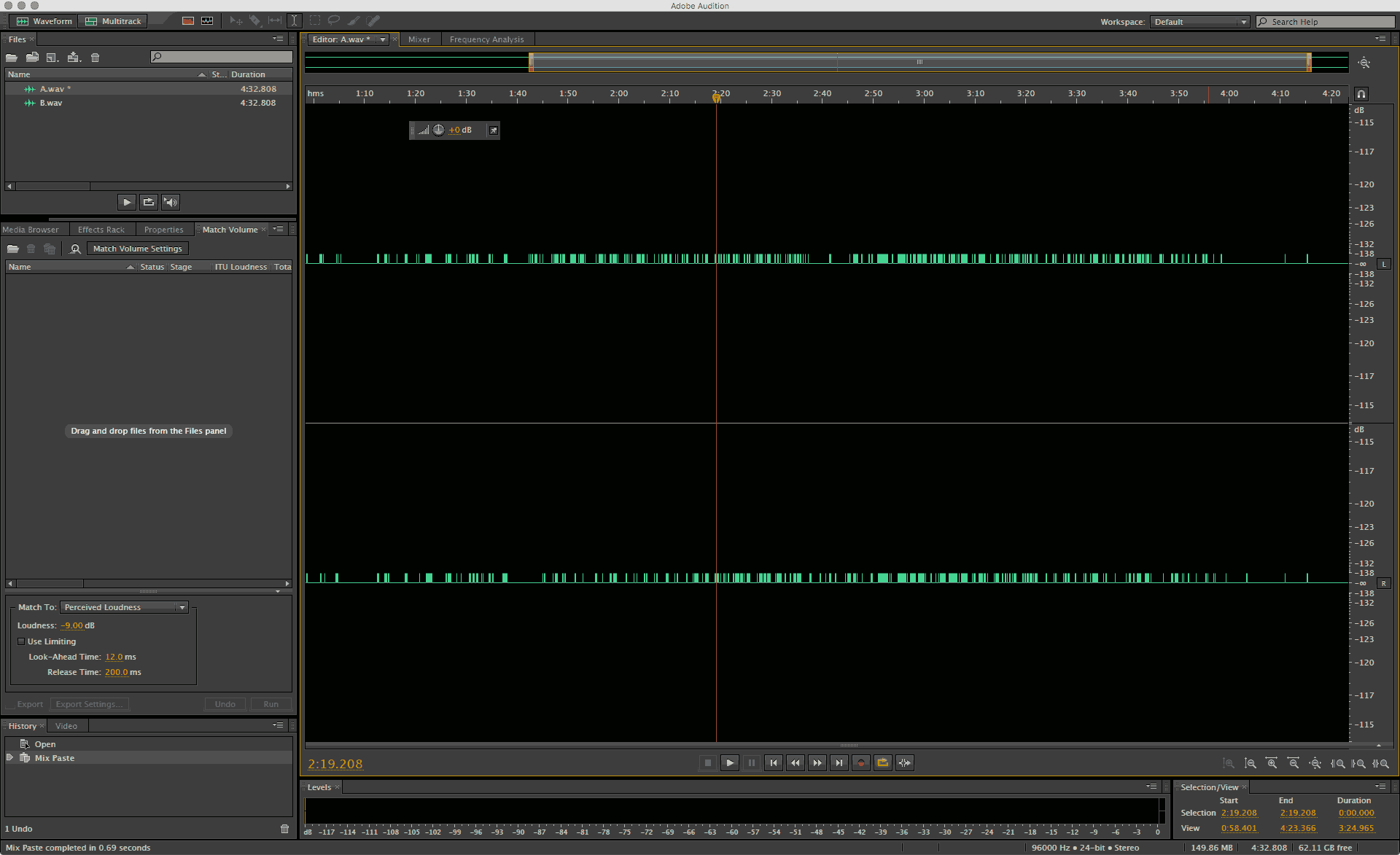

空也 Posted October 8, 2018 Author Report Posted October 8, 2018 Sada dolazimo do još zanimljivijeg dela testa!!! Bio sam radoznao, pa sam uzeo da uporedim izvorne originalne 24/96 test fajlove sa fajlovima koje je TASCAM “snimio” sa SPDIF izlaza HiFace-a. Na moje veliko iznenađenje, na prvi pogled, ni tu nije bilo razlike! Rezultujući null test fajl se takođe sadržao od tišine! Kažem na prvi pogled, pošto sam zumirajući vertikalnu dB osu glasnoće u Audition-u, ipak pri maksimalnom mogućem povećanju dobio neki slabačak isrekidan signal na otprilike -138 dB glasnoće. Quote
空也 Posted October 8, 2018 Author Report Posted October 8, 2018 Ovde je bitno imati u vidu odnos signal-šum ostale elektronike koja čini naš sistem! Tu imamo termalni šum u samom DAC kolu, šum analogne sekcije DAC-a, šum pretpojačala, pojačala, itd, itd, tako da je ovaj signal od -138 dB koji u tragovima postoji u fajlu, debelo zakopan u dubinama zbirnog šuma elektronike celog sistema. Tokom plejbeka ovog fajla možete do maksimuma odvrnuti volume potenciometar i iz zvučnika ćete čuti samo bazni šum sistema. Evo šta o praktičnoj, “slušnoj”, identičnosti fajlova testiranih nulovanjem kažu upućeni: https://music.tutsplus.com/tutorials/how-to-null-test-your-gear-part-1--cms-22425 Here are few points to keep in mind: - Any audio information from about -60dB and up left after a null test should be considered audible. Be sure, however, to double-check you are perfectly phase cancelling the original test tones - Anything floating around -90dB can be regarded as functionally inaudible. While you technically could hear it if you absolutely blasted your speakers, chances are that will not happen. Furthermore, in the mix that difference will probably end up getting buried- Anything around -110dB or lower is completely inaudible. Any two sources with a difference this low can be considered exactly the same U prevodu: -Ako imamo signal između 0dB i -60dB, razlike između falova su čujne. -Signal u zoni oko -90dB je praktično nečujan, moguće je da ćete nešto iz zvučnika ipak čuti ako odvrnete kontrolu glasnoće na aposlutni maksimum.-Signal počevši od -110dB pa naniže je potpuno nečujan, tako da se dva fajla između kojih postoji ovako mala razlika mogu smatrati identičnim. Quote
