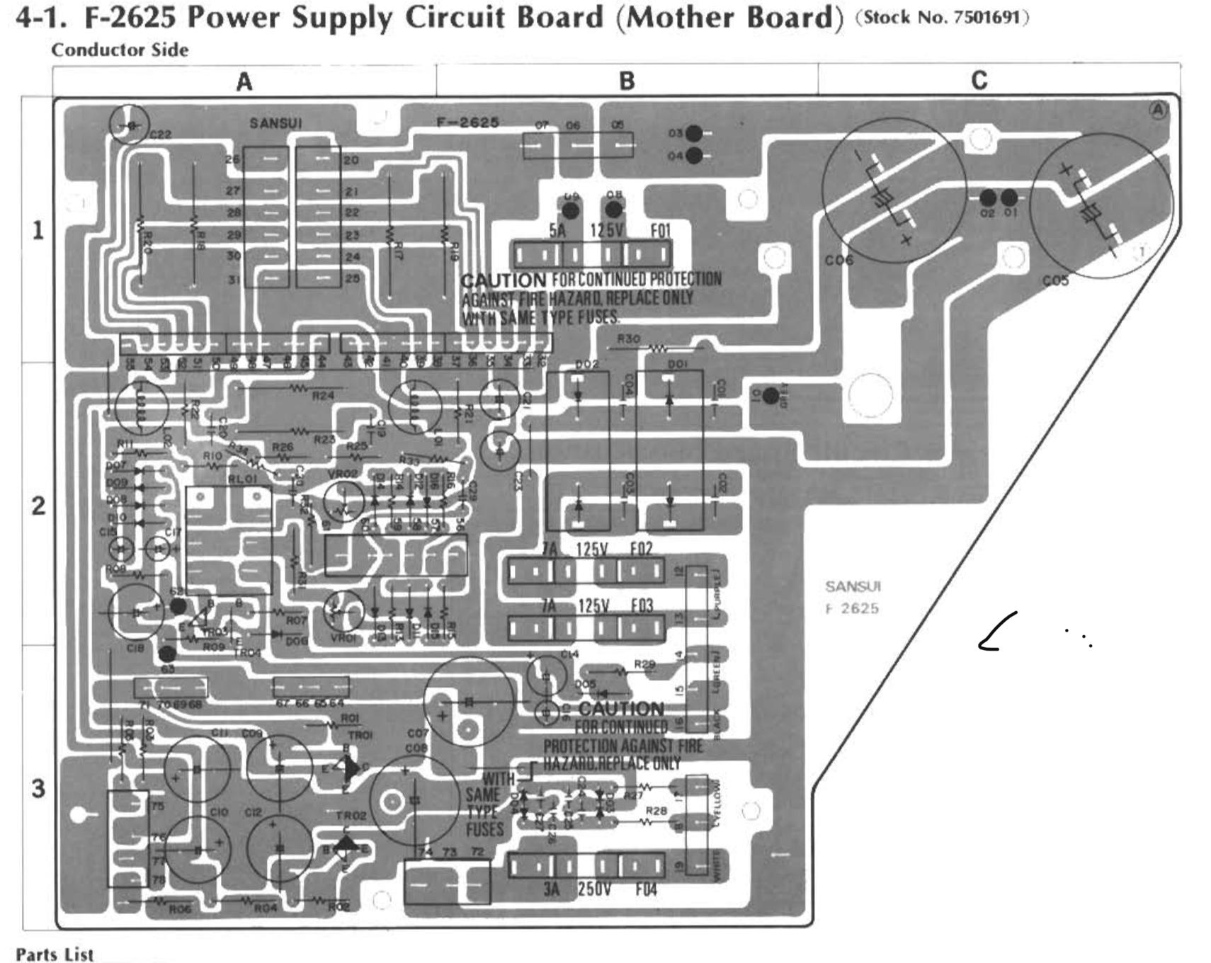

kepe Posted December 30, 2021 Report Posted December 30, 2021 Pozdrav Dobio sam 7070 sansui za reparaciju,raskopan,te ne mogu pronac gdje zavrsava jedna zica sa glavne ploce 2625 molim pomoc Quote

kepe Posted January 6, 2022 Author Report Posted January 6, 2022 tnx.nisam bio kod kuće,ali mislim da sam odgonetnuo kamo pripada,nastavak mi je na ploći 2624,pošto zaštitini relej uklopi ali nema dalje zvuka na zvučnicima Quote

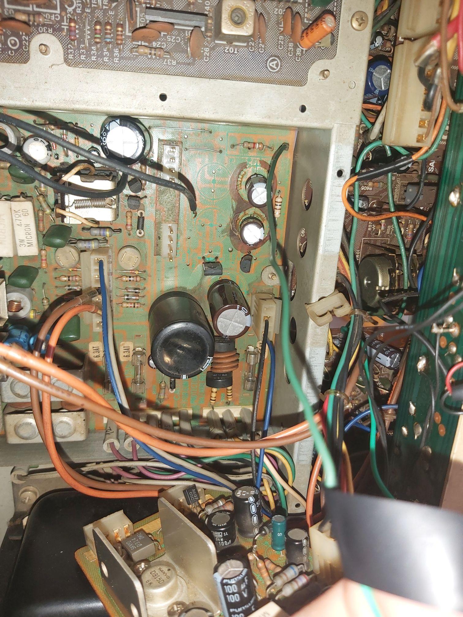

kepe Posted January 6, 2022 Author Report Posted January 6, 2022 na slici zelena žica na ploči 2625 gore desna u čošku i zavrpava na ploći2620,mislim da pronašao ju Quote
kepe Posted January 6, 2022 Author Report Posted January 6, 2022 On 12/30/2021 at 10:07 PM, mutayu said: Hajde obelezi gde je, koja je? Quote
mutayu Posted January 7, 2022 Report Posted January 7, 2022 Vidis da je tu nesto vec radjeno, dva kondenzatora zamenjena a jos dva nedostaju? Quote
giZ_Mo Posted January 7, 2022 Report Posted January 7, 2022 Ништа не недостаје, универзална је плоча. Quote
