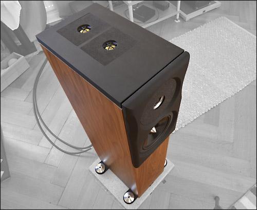

džonibigud Posted March 16, 2019 Report Posted March 16, 2019 Ako si čuo taj setup sa naim i dyn zvučnicima i sviđa ti se onda je ok. Ako nisi mislim da je u tom cenovnom rangu mnogo bolje upariti Naim nap 250 sa Neat Ultimatum XL6, ako planiraš jači setup. Quote
džonibigud Posted March 16, 2019 Report Posted March 16, 2019 SPECIFICATIONS HF Unit: 26mm SONOMEX Domed XL Super HF Units: 2* EMIT 25mm planar/ribbon Bass / Midrange: 168mm NEAT Bass/Mid Unit with Aluminium Phase Plug Bass Units: 2* 168mm NEAT Bass UnitsDimensions (hwd): 100x22x37cm Enclosure type: Multi-chamber, multi-driver array, incorporating isobaric internal cavity, plus upward firing super-tweeters Sensitivity: 87db/1 watt Recommended amplifier power: 25 – 200 watts Impedance: 8 ohms average / Minimum 5 ohms Weight: 34Kg each Quote
