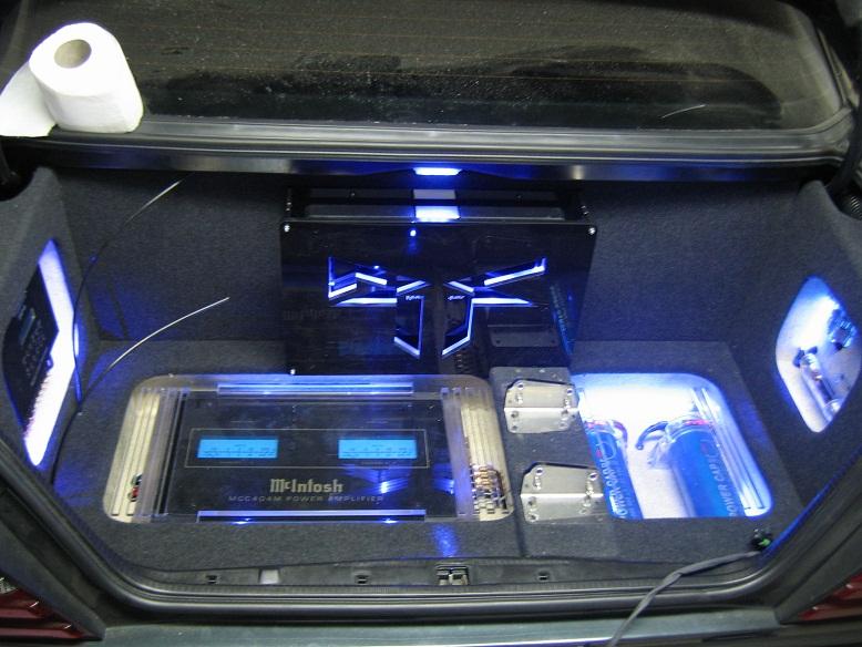

Nino Posted September 23, 2023 Report Posted September 23, 2023 Kasnim malo ali evo jedan 124 500E koji sam ja davnih godina radio, McIntosh pojačalo kao i Head Unit: Quote
Iron man Posted September 23, 2023 Report Posted September 23, 2023 Jaoooooo Jel ova lepota u gepeku? Quote
Nino Posted September 23, 2023 Report Posted September 23, 2023 Da, ali ne u autu iz teme, skroz druga ugradnja. Quote
