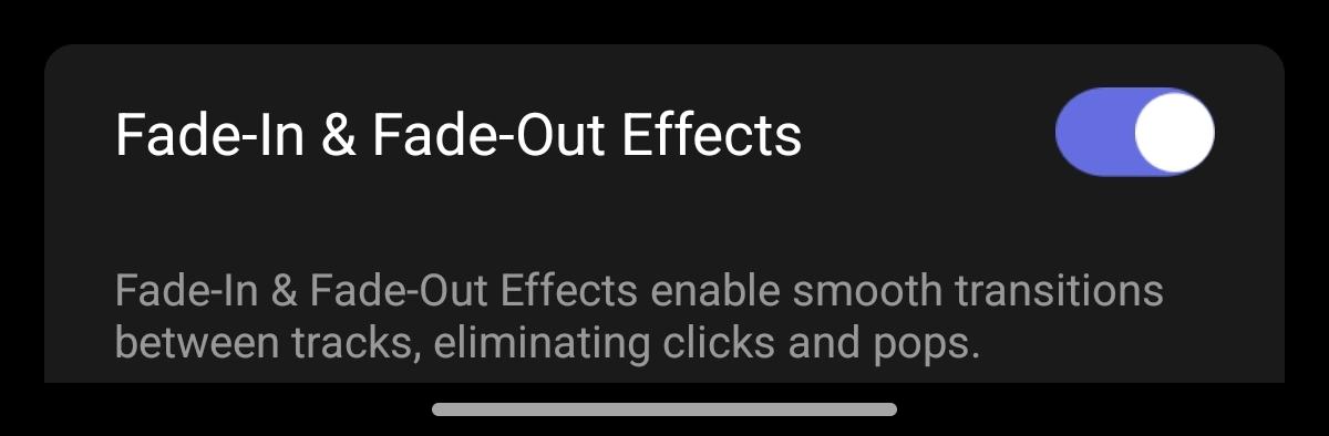

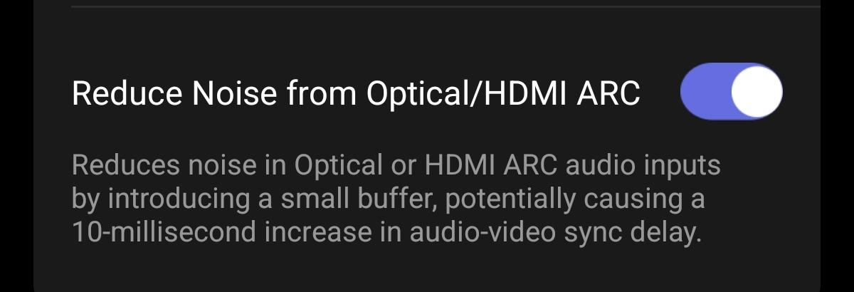

marivoje Posted March 6 Author Report Posted March 6 Na wiim ultra imaju 2 opcije za to, i obe su upaljene: Quote
