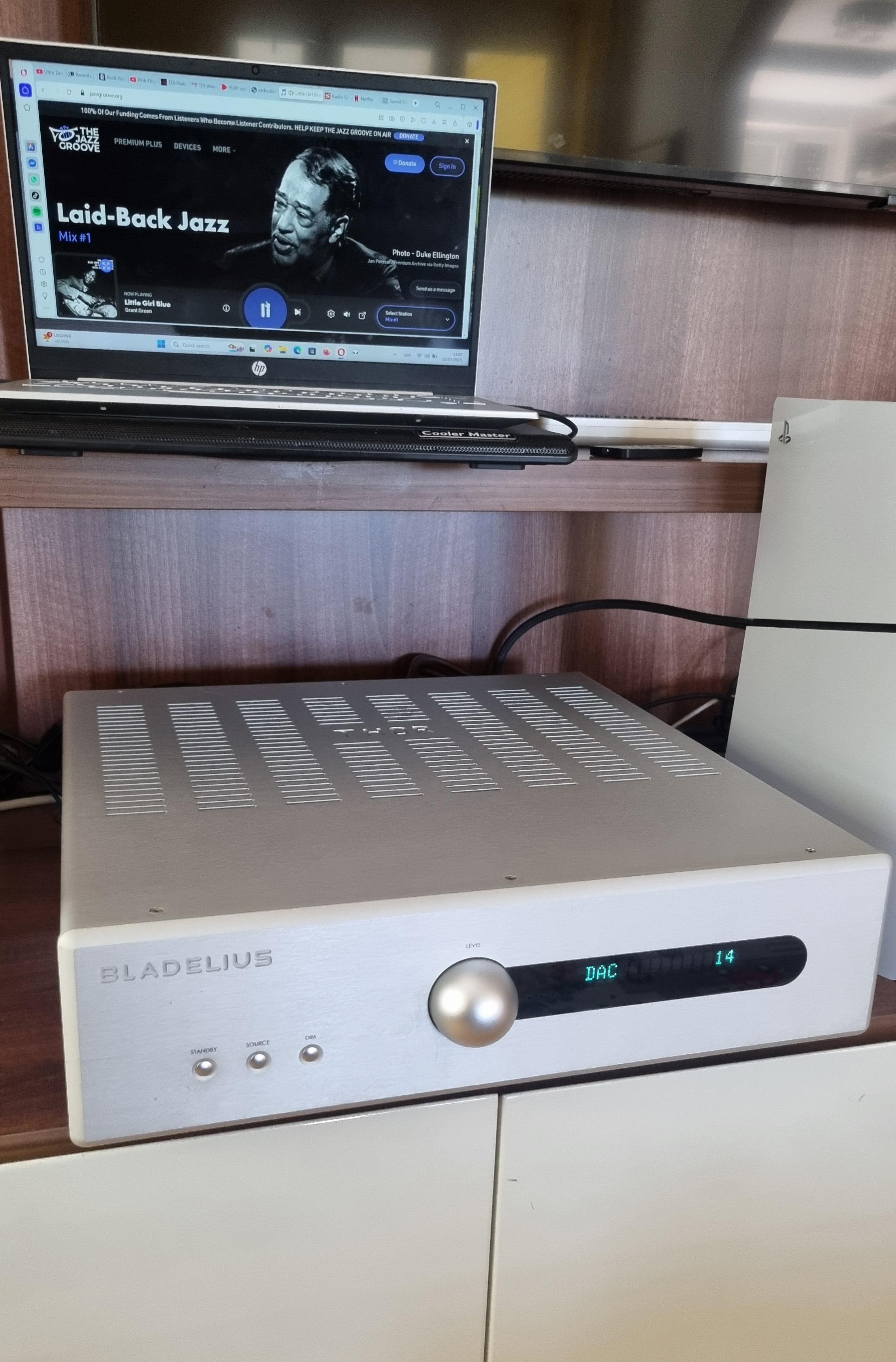

durd Posted July 2, 2025 Author Report Posted July 2, 2025 Evo ga sređeno, radi kao lutka...... @giZ_Mo rešio. Quote
durd Posted July 3, 2025 Author Report Posted July 3, 2025 On 2. 7. 2025. at 17:16, Iron man said: Šta mu je bilo? menjao mu je neke kondezatore....🙂 to se sećam da je rekao. jedino da on napiše ..👍 Quote
