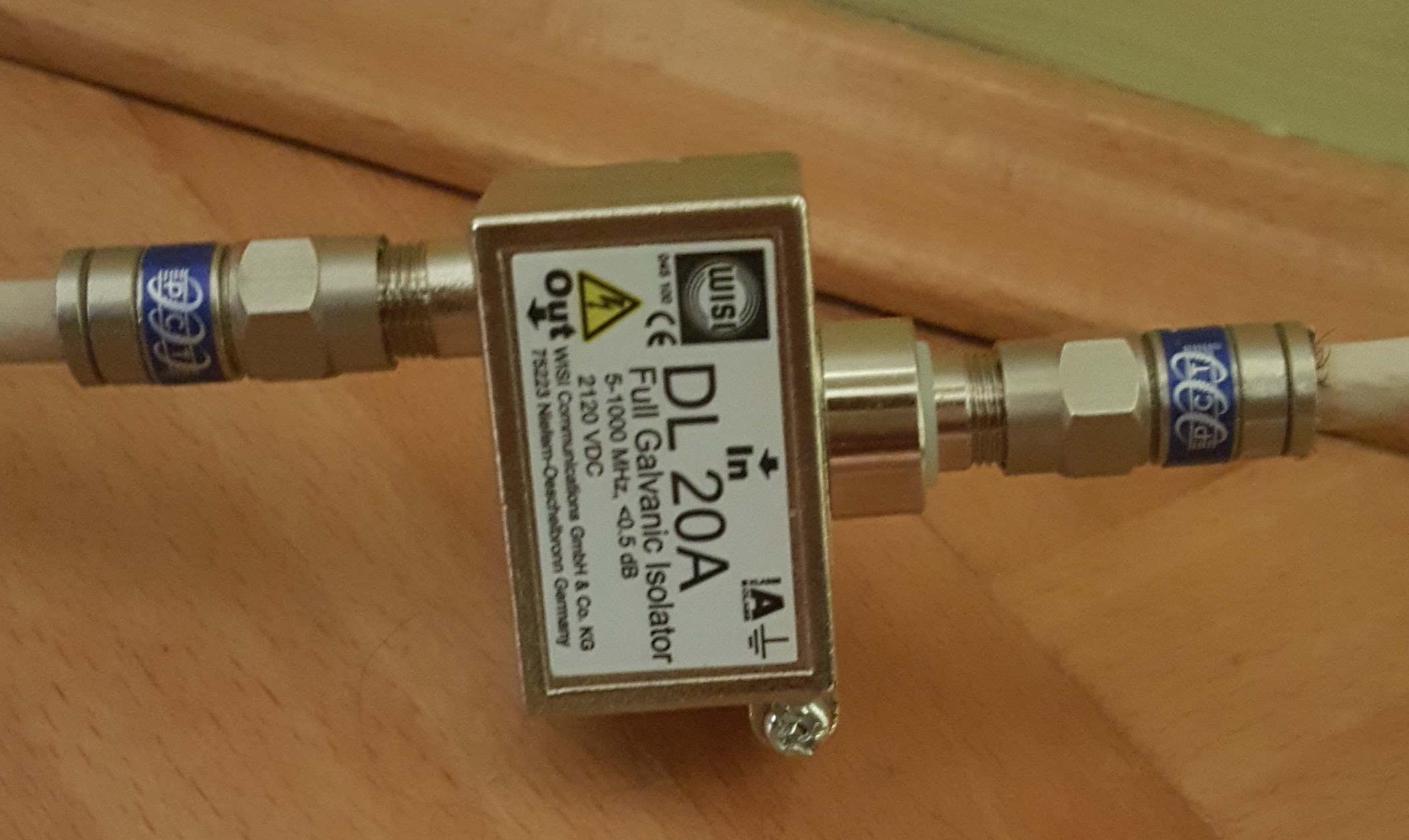

zek Posted January 26 Report Share Posted January 26 Valja li ovo nešto ... Quote Link to comment Share on other sites More sharing options...
gvlada Posted January 26 Report Share Posted January 26 Ако не пецка после њега, ради посао. Quote Link to comment Share on other sites More sharing options...
