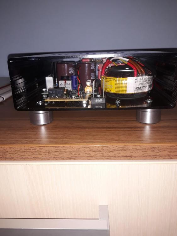

Nixie Posted January 9 Author Report Share Posted January 9 Da to je prava sprava. Kad treba rupa da se izbuši na elektro ormanu, stepenasta burgija nije nikakvo rešenje. Naročito ova iz Lidla. Ali nemaju svi probijač. Quote Link to comment Share on other sites More sharing options...
Nixie Posted January 9 Author Report Share Posted January 9 Sve izbušeno i namontirano. Sad idu sitna crevca. Quote Link to comment Share on other sites More sharing options...

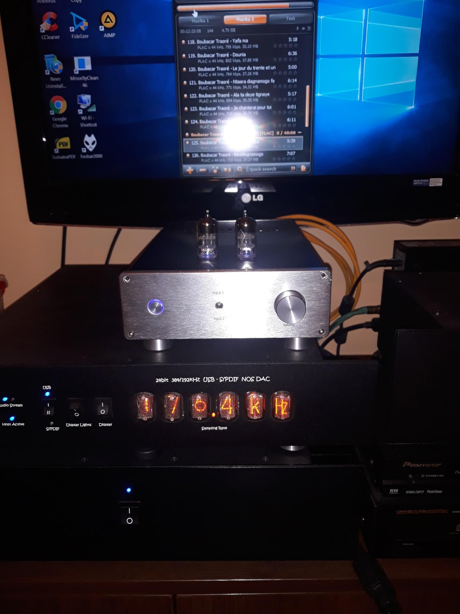

Nixie Posted January 15 Author Report Share Posted January 15 Kičerica Quote Link to comment Share on other sites More sharing options...

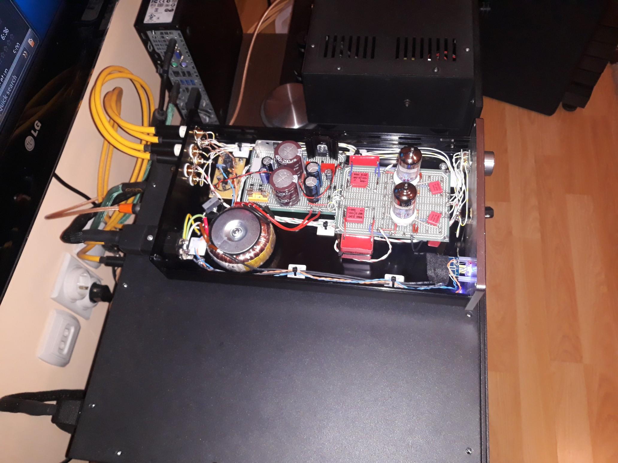

Father Posted January 15 Report Share Posted January 15 Daj jednu sa poklopcem i upaljenim lampama. U plastičnoj kutiji je radio kao bombona, mada sa onim VdH strujašem je baš blistao. Nadam se da u novom metalnom sanduku diže iz mrtvih. 😜 Quote Link to comment Share on other sites More sharing options...
Nixie Posted January 15 Author Report Share Posted January 15 Stajalo par godina, bilo mi žao da ga bacim. Trebalo bi bolje da zvuči sa novim napajanjem. Sutra ga završavam, nadam se. Quote Link to comment Share on other sites More sharing options...

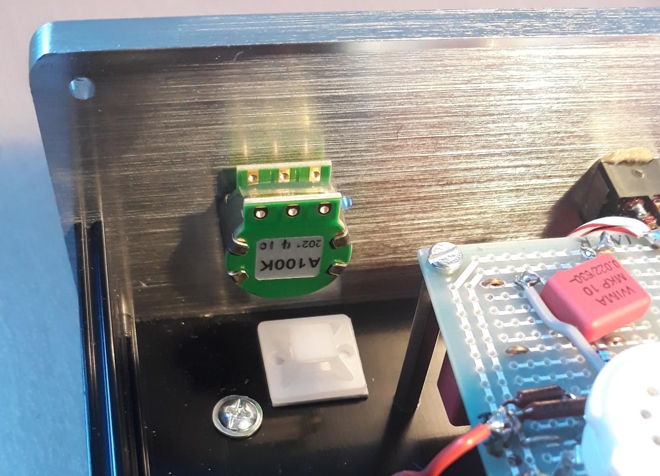

Iron man Posted January 15 Report Share Posted January 15 Turi neki knob na taj fake pot. Bode oči ovako. Quote Link to comment Share on other sites More sharing options...
Nixie Posted January 16 Author Report Share Posted January 16 To na kraju ide, dugme stavljam kad se sve završi. Nije nikakav fake pot, nije ni pot, ovaj je SMD preklopnik i odličan je. Quote Link to comment Share on other sites More sharing options...
giZ_Mo Posted January 16 Report Share Posted January 16 ovaj je SMD preklopnik i odličan je.Стави дугме на тај фејк СМД преклопник Послато са Redmi 4 помоћу Тапатока Quote Link to comment Share on other sites More sharing options...
Nixie Posted January 16 Author Report Share Posted January 16 Nije fake, Kineski original. Za svaku preporuku je zvučno i po ceni. Šije Alps RK27 original ali nije direktna zamena jer nema isti navoj za montažu. Quote Link to comment Share on other sites More sharing options...

Nixie Posted January 16 Author Report Share Posted January 16 35 minuta ranije, RADE said: Upravo sam otkrio da postoji i verzija preklopnika u alps rk27 kućištu: Ja to koristim odavno, baš taj RH2702 sa 21 položajem i izvodom za loudness koji ne koristim. Lično mislim da su bolji ovi manji. Taj RH27 je neprirodno trvrd, traži veliki moment za okretanje. Navoj mi je malo veći, 9mm pa treba širiti rupu ako se stavlja umesto RK27. Zvučno nema neke velike razlike u odnosu na ovaj manji. Quote Link to comment Share on other sites More sharing options...

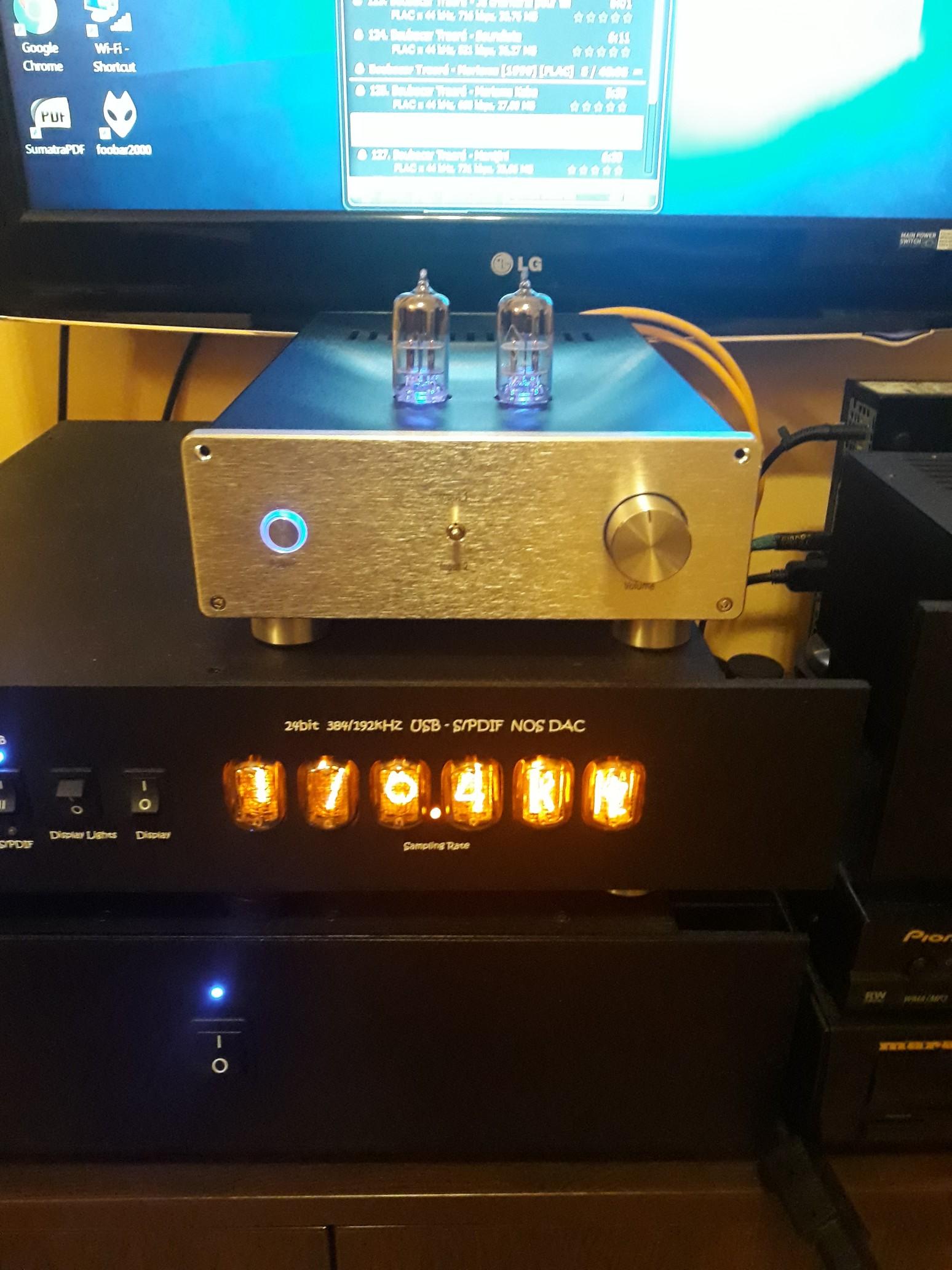

Nixie Posted January 16 Author Report Share Posted January 16 U međuvremenu je proradilo. Quote Link to comment Share on other sites More sharing options...
