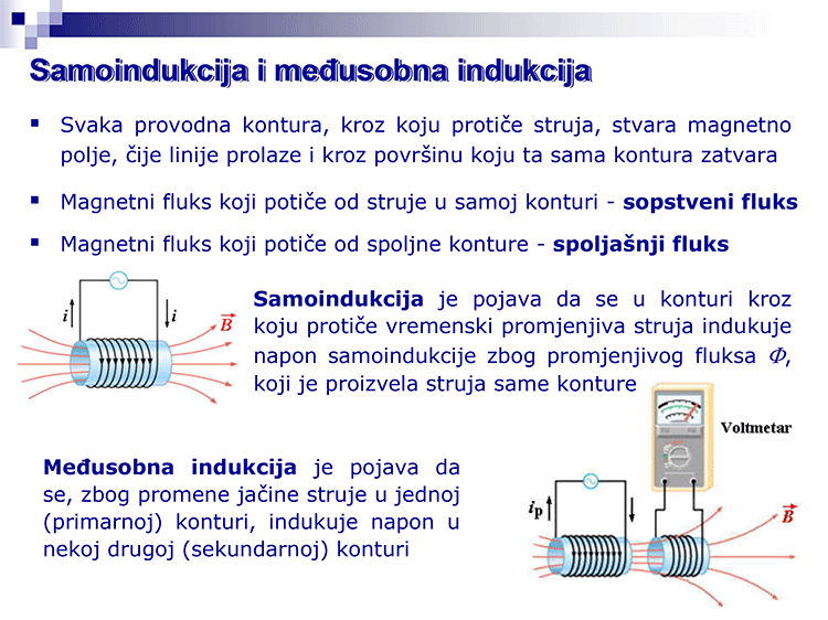

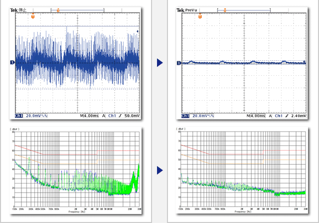

空也 Posted May 12, 2014 Report Posted May 12, 2014 @kuja ... i kako to struja u zicu od 5V koja je izolovana dielektrikom "prlja" (pazi koj neodredjeni termin) ostatak vodova u sklopu kabla? ... Auuuuu! Ovo pitanje ti je ozbiljno? Za kvalitetni nastavak diskusije bi mozda ipak trebalo poznavati neke osnove... Ako pratis temu Jugonostalgija, mozda da se raspitas gde se moze nabaviti Elektropionir koji je proizvodila Mehanotehnika iz Izole?http://www.njuskalo.hr/djecje-igracke/mehanotehnika-elektro-pionir-kompletno-oglas-5583096 Meni je mnogo pomogao kada sam se kao klinac igrao sa njim. Cuo si za indukciju i elektromagnetno "zracenje" iz kablova?[ A... kako ta medjusobna indukcija moze da nam smeta? Electromagnetic Interference (EMI) Electromagnetic interference (EMI) can interfere with the transmission of signals. EMI is only a problem with copper cabling.It’s caused when the changing electromagnetic fields generated by one cable induce extraneous currents or interference in adjacent or nearby cables. EMI in copper cabling can be reduced to acceptable levels by: 1 Avoiding bunching of unshielded cabling2 Keeping all cabling away from power cords and transformers3 Using shielded twisted-pair (STP) cabling instead of unshielded twisted-pair (UTP) cabling4 Enclosing cabling in external mesh or wire shielding5 Properly grounding electrical equipment and external shielding6 Taking care not to excessively untwist the terminating ends of twisted-pair cabling "Prljanje" je uzrokovano "prljavom" strujom koju proizvode mnoga switcherska napajanja u PC-ju. Te visokofrekventne smetnje se gore pomenutom indukcijom mozda mogu preneti iz 5V vodova u data vodove USB kabla ako ne postoji zastita u vidu shielda. The disadvantages of a switcher are that the switching component adds quite a bit of noise to the output power. I’ve seen many different switching frequency signatures ... More commonly the switching frequency is up in the tens of kHz with some sub-harmonics extending into the audio band, plus possibly also some low-frequency ripple. Then there are the really cheap switchers, with a switching frequency right in the middle of the audio band. Na slici levo mozes videti "prljave" smetnje koje unosi lose switchersko napajanje. Tol'ko? PS Da se ogradim, ovo je bio samo direktan odgovor na pitanje: "i kako to struja u zicu od 5V koja je izolovana dielektrikom "prlja" (pazi koj neodredjeni termin) ostatak vodova u sklopu kabla?" Bez audiofilskog vudua. . Quote

Kaiser Posted May 12, 2014 Report Posted May 12, 2014 @kuja Cudo kako uopste elektronika funkcionira pored toliko indukcije. Dali u taj tvoj kabl od 10 eur zbog previse indukcije od 5V bus u DAC ne stize bit-identican fajl sa kompa? BTW magnetno polje oko 5V vod je otprilike 1 Gauss ako uredjaj trosi 500mA na radius od 1mm, a prirodno magnetno polje oko zemljine planete je 0.5 Gaussi. Ako DAC trosi recimo 100mA onda je magnetno polje na 1 mm 0.2 Gaussi. Quote
空也 Posted May 12, 2014 Report Posted May 12, 2014 Vidis kako Gugl pomaze! Citaj jos! Planeta Zemlja se napaja iz switcherskog napajanja? Quote
