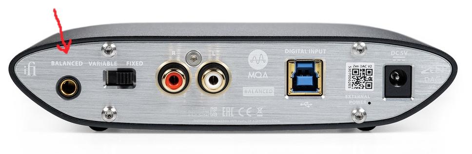

damic Posted July 8, 2021 Report Posted July 8, 2021 Imam utisak da je na ovom Aurisu ugradjen noviji 4,4mm TRS bal konektor kako se radi na novijim dakovima malog kucista. Za klasicni XLR, trebala bi daleko veca kutija. Bas sam kod mene uporedio novi dac Topping D50S, sa starim Teac D-10, laksi je 20 puta a zapreminski manji 28. https://www.ranecommercial.com/kb_article.php?article=2107 Quote

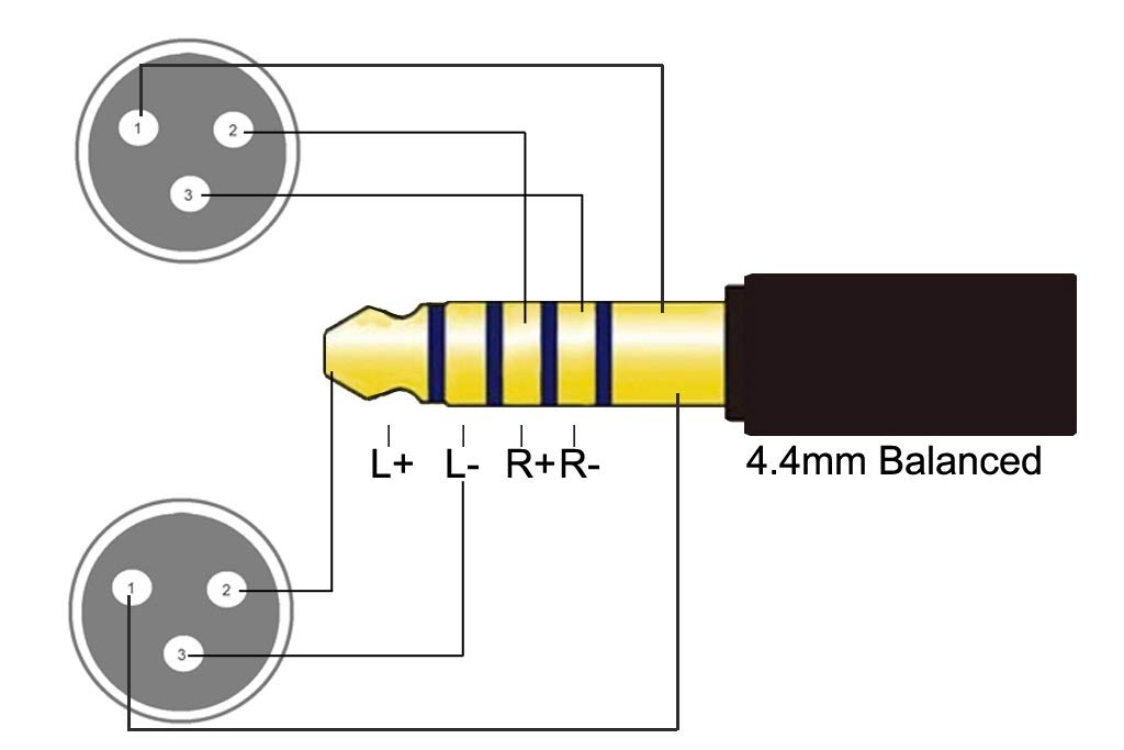

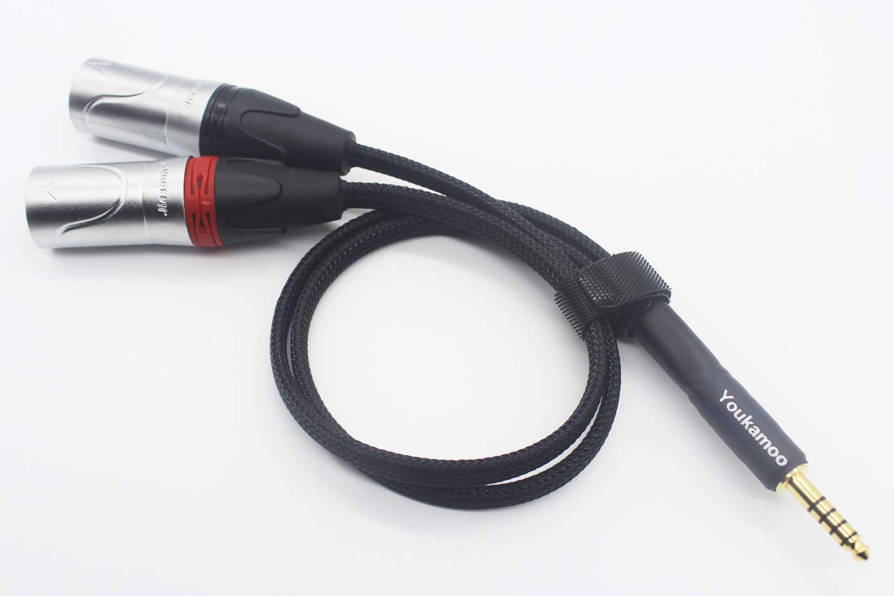

Father Posted July 8, 2021 Report Posted July 8, 2021 STEREO 4,4mm TRS balansirani kabl sa dva XLR (L i R) sa druge strane. 4.4mm to Dual XLR Male Balanced Audio Headphone Adapter Silver Plated Cable 1 FT 0.3M Quote
somilenko Posted July 8, 2021 Report Posted July 8, 2021 To je TRRRS stereo konektor za slušalice Quote
Father Posted July 8, 2021 Report Posted July 8, 2021 Ne može da se koristi kao XLR balansirani izlaz DAC-a? Problm impedanse i slično? Quote
somilenko Posted July 8, 2021 Report Posted July 8, 2021 Zavisi, može svašta biti, ali je jedno sigurno, treba im bolji PR. Quote
Father Posted July 8, 2021 Report Posted July 8, 2021 Znam iz ličnog iskustva. Edit: Mislim na PR. Quote
nkrgovic Posted July 8, 2021 Report Posted July 8, 2021 Ajde da se razumemo: - Balansirani izlaz je opis topologije. - XLR je konektor. Apsolutno je moguce imati balansirani izlaz i na XLR i na DIN i na TRRRS . Moguce je imati i npr. Single ended stereo na XLR. Quote
zek Posted July 8, 2021 Report Posted July 8, 2021 Evo imaju i drugi balansirani izlaz a da nije XLR već 4,4mm TRRRS. Quote
