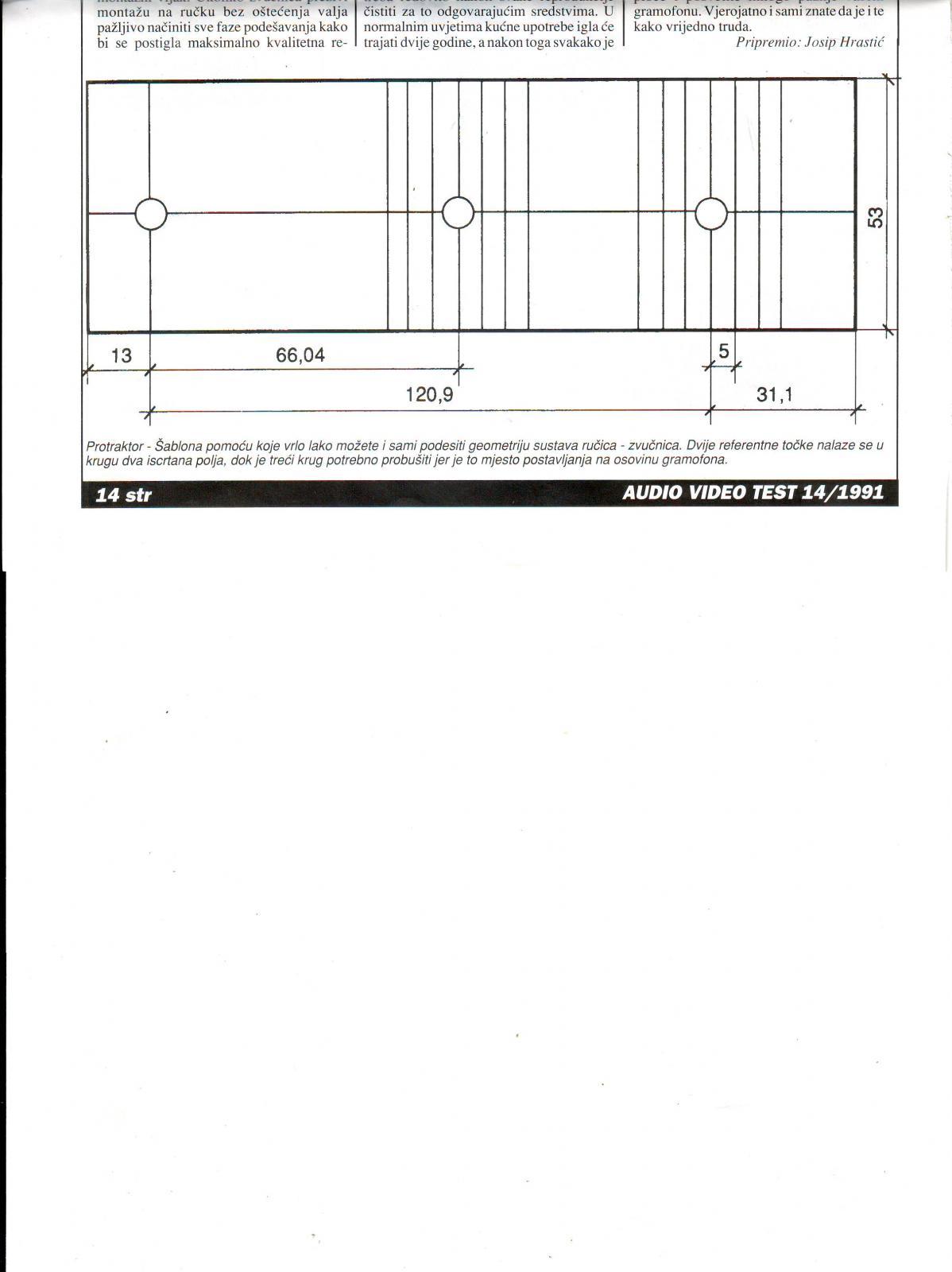

Bato - hi - fi Posted April 21, 2013 Author Report Share Posted April 21, 2013 Evo mene,a bas ste se pitali dje je oni dosadni "djetic"?Pitanje valja li sto ovi protaktor koji sam nasao u AUDIO TESTU BR.14 iz 1991 godine.Na mom plastikaneru je "overhang" 16 milimetara. Quote Link to comment Share on other sites More sharing options...
Bujodrag Posted April 21, 2013 Report Share Posted April 21, 2013 Å to ne bi valjao? To je Baerwald Stupid protractor. ve_stupid_protractors.pdf Quote Link to comment Share on other sites More sharing options...
Bato - hi - fi Posted April 21, 2013 Author Report Share Posted April 21, 2013 Å to ne bi valjao? To je Baerwald Stupid protractor. ve_stupid_protractors.pdf Znachi izrezem,nabodem,prvo "overhange",pa one dvije tacke i pevaj!? Quote Link to comment Share on other sites More sharing options...
Ljuba Posted April 21, 2013 Report Share Posted April 21, 2013 Spojena tema sa starom koju je otvorio isti clan!!! Quote Link to comment Share on other sites More sharing options...
giZ_Mo Posted April 21, 2013 Report Share Posted April 21, 2013 Znachi izrezem,nabodem,prvo "overhange",pa one dvije tacke i pevaj!? Да. Quote Link to comment Share on other sites More sharing options...
Maks Posted April 22, 2013 Report Share Posted April 22, 2013 Prostije biti ne može. Quote Link to comment Share on other sites More sharing options...

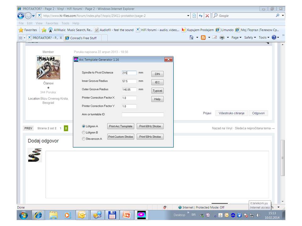

Mingus,Mingus Posted February 10, 2014 Report Share Posted February 10, 2014 Da ne otvaram temu, nasao sam od ranijih tema intersantan programcic za stampanje,arc template generator.Sta da upisem efektivnas duzina rucke je 215mm sta pisati u polju inner groove radius,outer groove radius,gramofon je 1210mk2. Quote Link to comment Share on other sites More sharing options...
